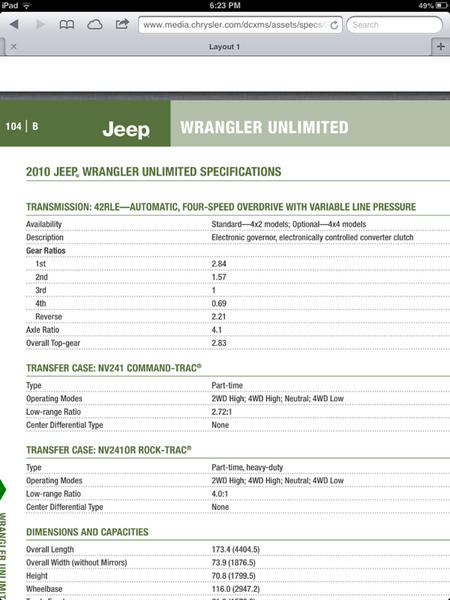

I guess this answers my question. 4.1 stock automatic JKU
