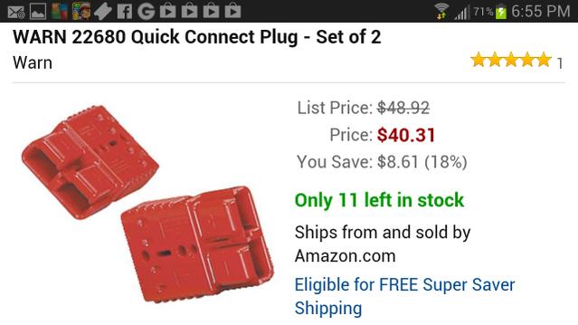

Warn has these. You can also add a handle to these to reduce stress on the wires. We use to connect battery chargers to electric forklifts. Much cheaper on ebay but you know it works if warn sells them.

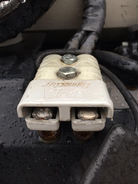

I bought 2 of the electric forklift charging plugs at our local Weise forklift store for around $10 each. I looked around after finding the other choices just seemed too expensive for a plastic plug-in. And these are identical to the expensive ones.
I have one on the front and back of my jeep, one on my jumper cables and one on my 10k lb winch for the rear. I'm about to add one to the front of my new truck too for jumper cables and possibly a winch in the future. I use the jumper cables a lot helping others and it's awesome not having to lift the hood, just plug up and go.
