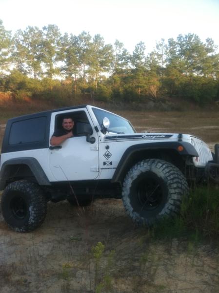

I have the 2dr coils and got well over three in the front with a winch and bumper. I ripped my front driveshaft boot the first time I Maxed out the flex at URE. I replaced it with one from Carolina drivetrain.

Do you have any current pics?

Look in my albums for more
