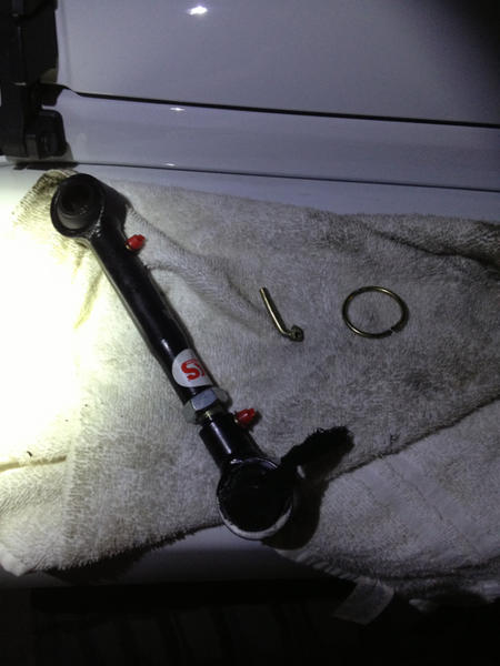

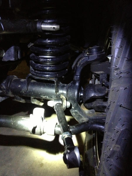

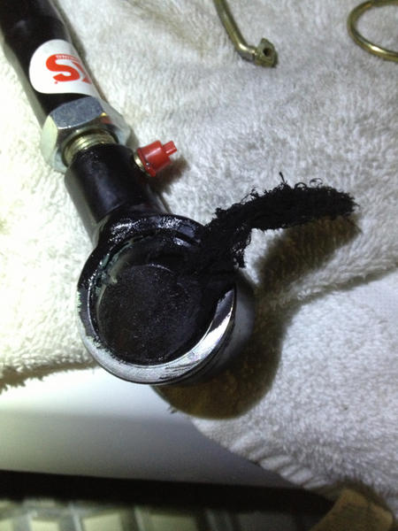

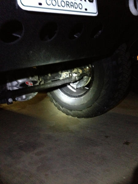

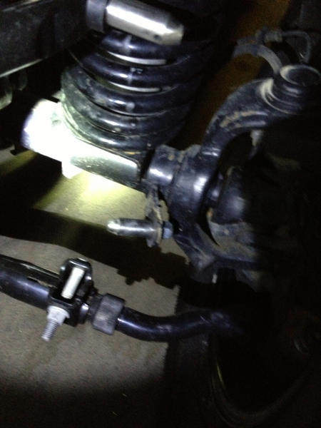

Looked under the jeep and the top of my jks quick disco came disconnected on the drive, laid over forward and was making contact with the inside sidewall of my tire. It also bent the lower mount and mounting post. I was able to get the disco off with a hammer and some vice grips.

2) take a look at the tire, it wore it down pretty good. They are MTRs with pretty thick sidewalls, so they aren't bulging or anything that looks too dangerous, but should I be safe and mount the spare, or just run on it?
3) I am pretty sure the jks arm is screwed, the joint that was rubbing on the tire and bouncing around is all jacked looking. Anyone think I could some how get this warrantied? The culprit was the cotter pin combing loose. I specifically inspected it this morning before I left and it was installed by a reputable shop. They are only a week old.
4) how much damage did I do to te lower mount? Is this something that I could bend back in place? Or am I screwed?

Take your jeep and disco to the shop that did the work, if they are reputable they will repair and replace parts. And its OK to run with only one, just slow down around turns and try not to do any sharp maneuvers.
you can drive it w/ the drop links disconnected - but its dangerous, i would drive it but i would be VERY VERY careful
when turning at at thing other than low speed....and let me further say, driving w/ the front sway bar disconnected is NOT
recommended.
you should be able to HAMMER that mount straight(er)....im gonna guess a small 3 lb sledge would do it.
put the disconnect back on & drive it...even if the bushing is messed up on the outter edge (per the pic) you should be fine, but
again take it VERY VERY easy in turns.
I have a set of STOCK drop links if you want 'em but, even if you paid fedex you wouldnt get 'em for another day.
Surely theres a JK member close to you that can lend a hand & hammer to straighten that mount back enough to get you rolling
again.
Truck stops are 24/7 and usually have a mechanic on duty - theyll even be open on Christmas & should be able to lend you a hammer or straighten the mount/tab for you.

I would get that tire checked or swap the spare on too, I can't tell from the picture how bad it is, but you don't want a sidewall blowing out on you @ highway speed.

I am thinking that the snap ring was not properly installed.

You can fix the lower mount with a BFH.
Can't tell how bad the damage to the fire is from your pictures, much as well swap the spare just in case, that's what it's there for.
