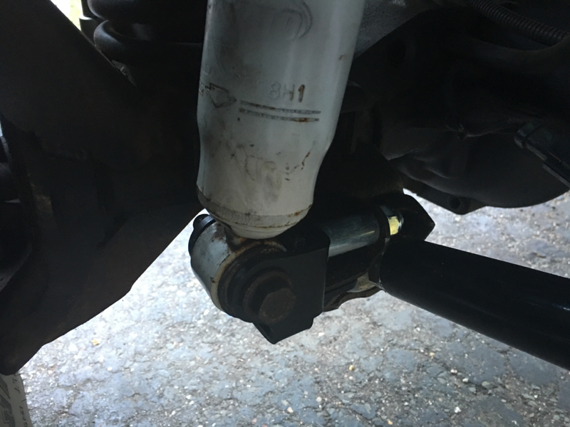

Rk 3.5's with 11.2 travel ranchos. 2.5 stop leaves .25 shaft at full bump. Also run JKS lower mounts.

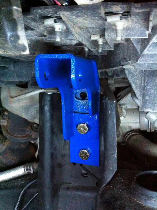

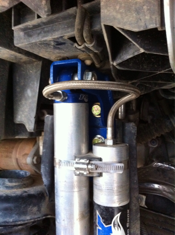

Jaker used MC upper mounts. He cut the tower off at the top. Bolted and welded the uppers higher than the shock tower. Edit for pic
yeah I saw that but that looks bad to me and I don't have that type of upper attachment on my shock. Trying to avoid returning the shocks for any reason also
Cool mod but would seem easier to drop the lower mounts.
