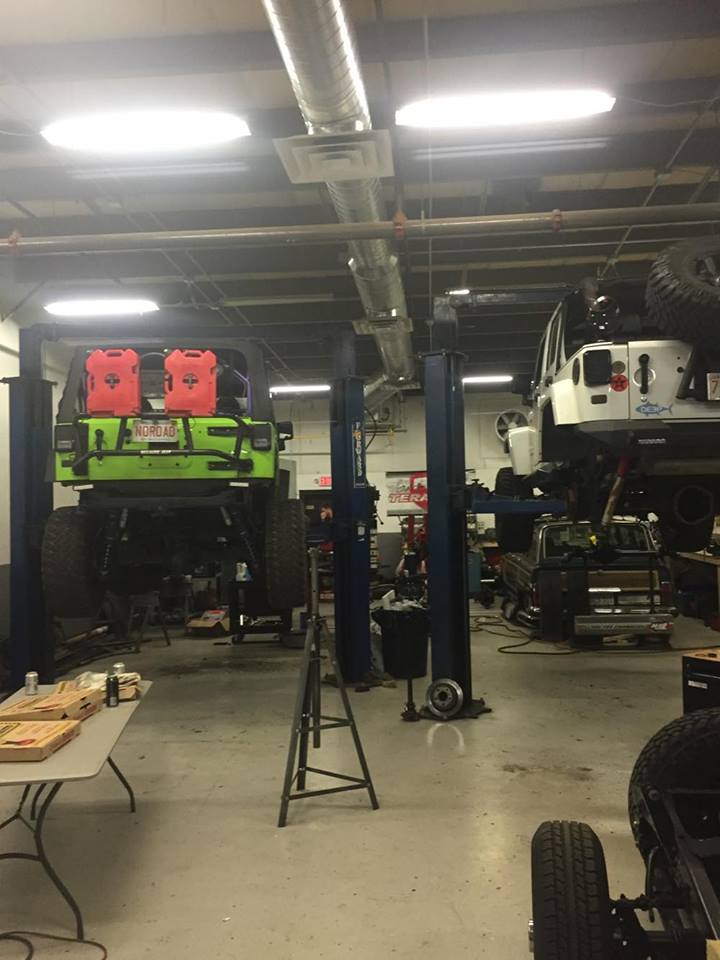

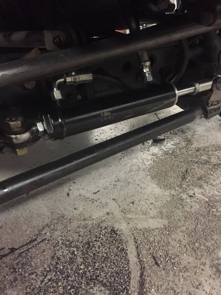

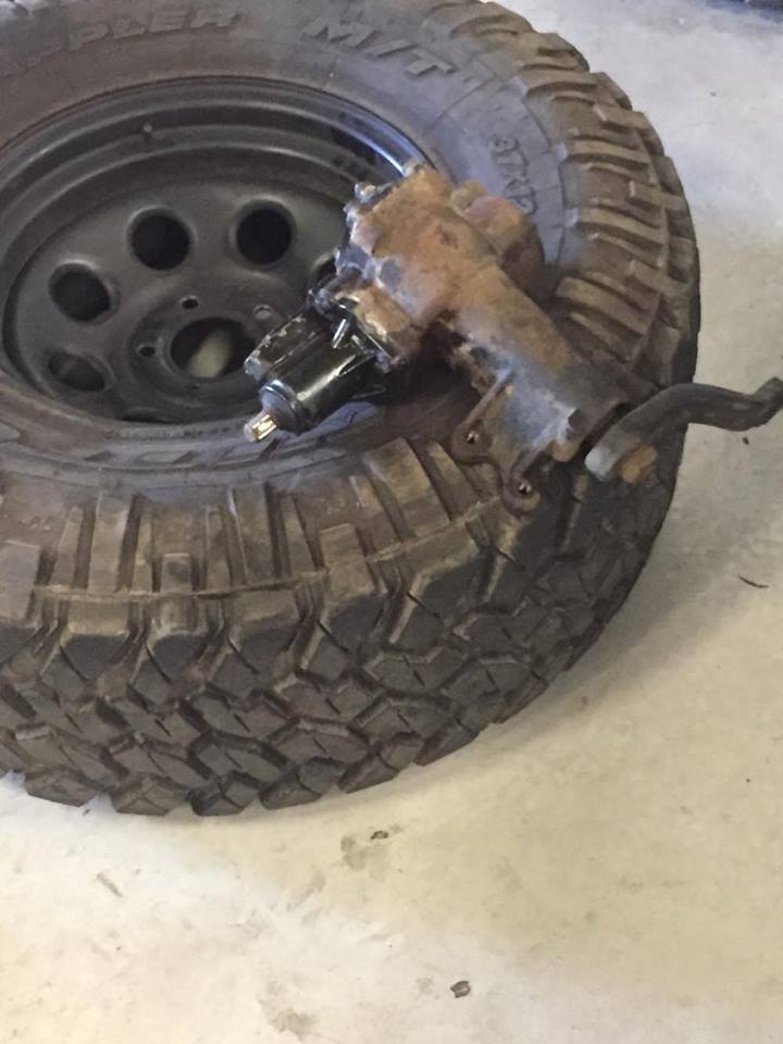

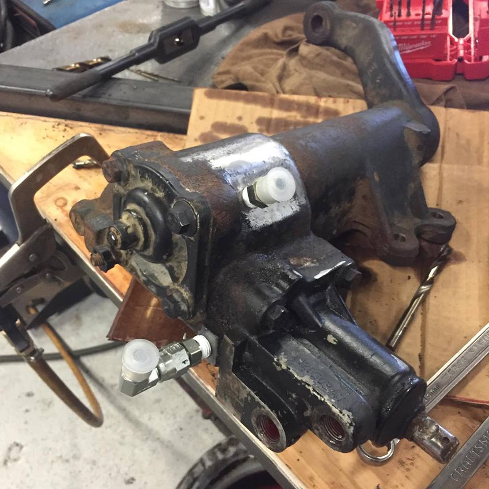

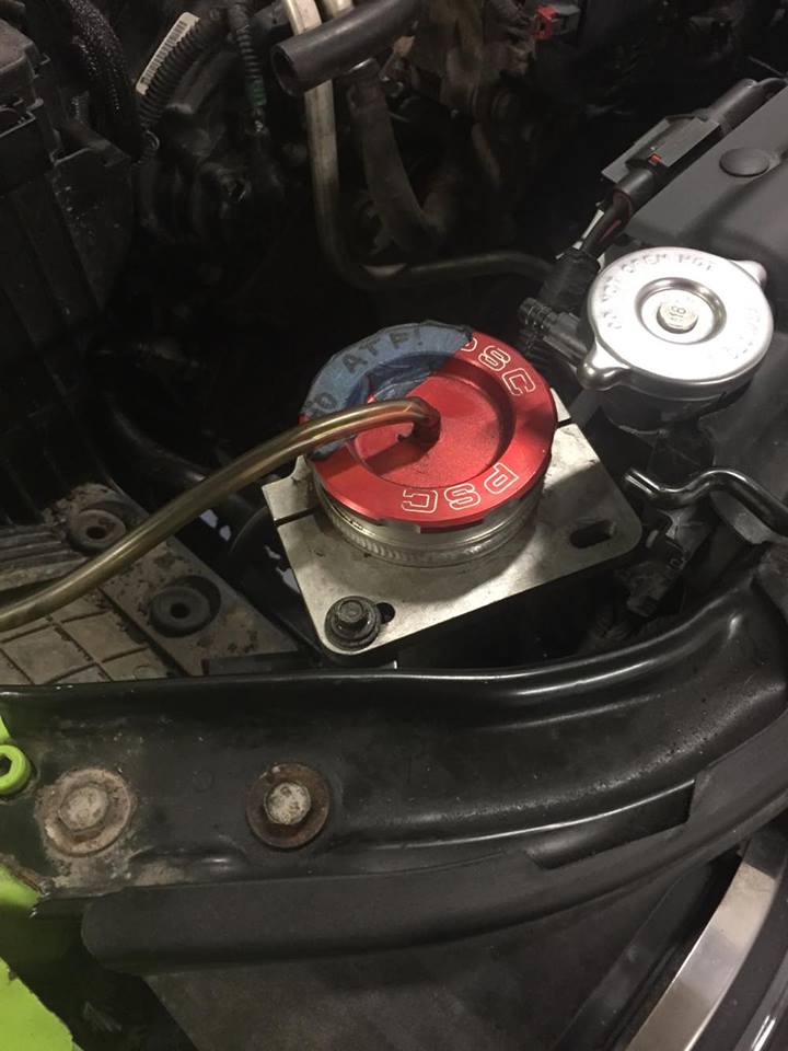

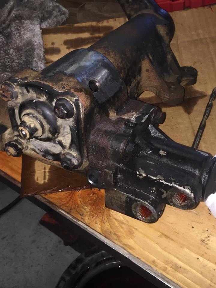

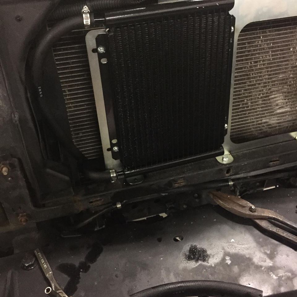

Finally got around to installing my Ram assist this weekend!

Looks good. I'm pretty much done with my install, I just gotta hook up lines to my cooler and ram.

Nice install! What ram are you using? I wanted to do the Ram assist on my new JK, but it appears PSC no longer sells the 1.75x6.75 cylinder I used on my last build.
thank you and I have 1.5 x 8inch PSC

What box do you have? I have a West Texas one and trying to figure out if I have my lines backwards or I need a new pump. I hooked the top port to the far side of the ram and the side port from the box to the closer side. Turning at idle is slightly tough but not horrible.
