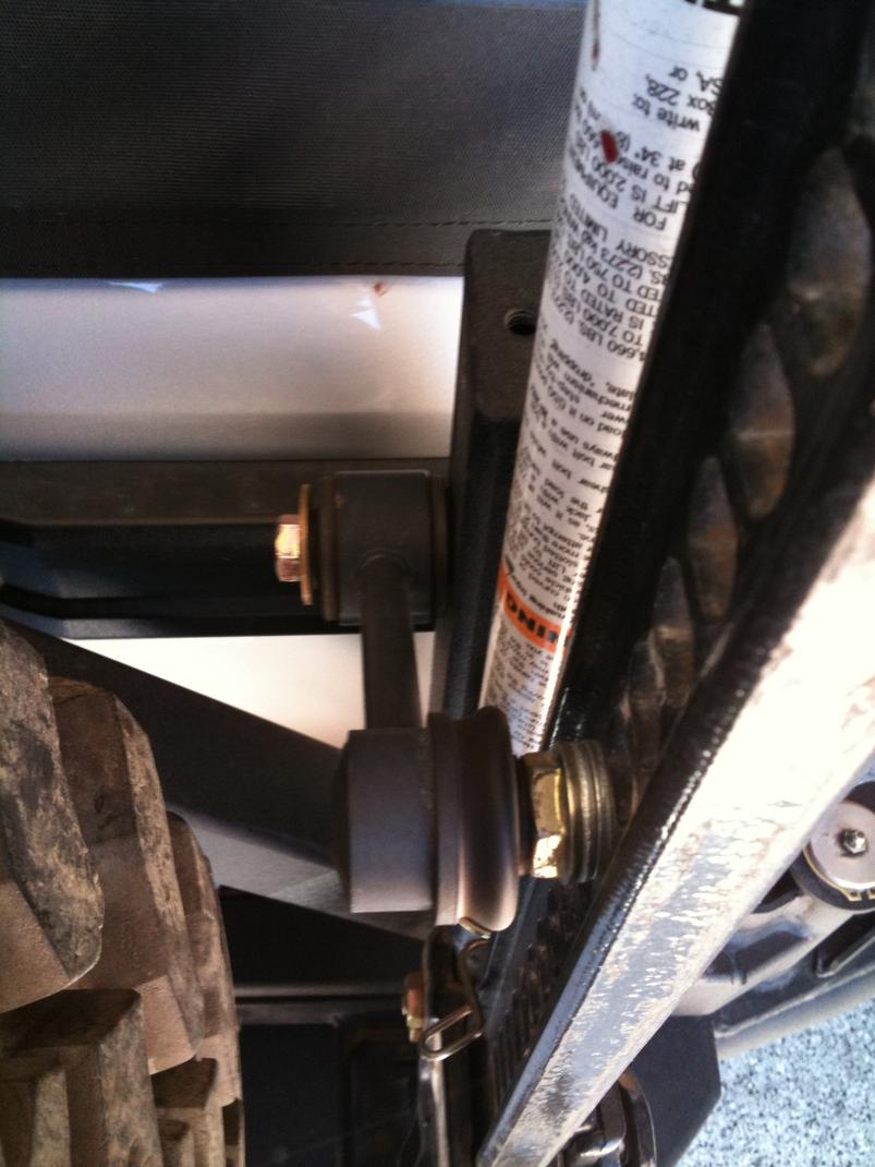

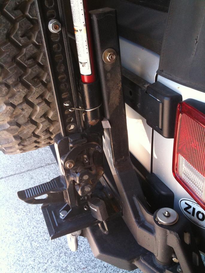

this is what i did with the rampage jack mount. i got tired of the jack constantly rattling loose and bouncing around. so heres the way i rigged mine up. no more movement and no more rattle! thanks goody for the ideas and help!

welded extra post of square tube to swing away.

recycled an old sway bar link. this is the key for the no movement and no noise!

any movement the link takes care of that with the rubber bushings.
mod took about 2 hours to do and about 2 years to figure out something that works! the only orginal part of the mount is the base. it was the only goo thing about the mount!
