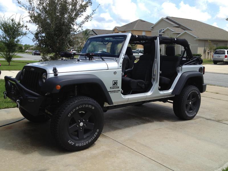

I've got the 3.25" lift on mine and I love it. Personally to me the ride quality is a lot better over the stock suspension.
I've got 33's on right now but as soon as they are done plan on going to 35's and that's about as big as I'll go.
Here's how she sits now, since this pic I've added Smittybilt Side Armor
