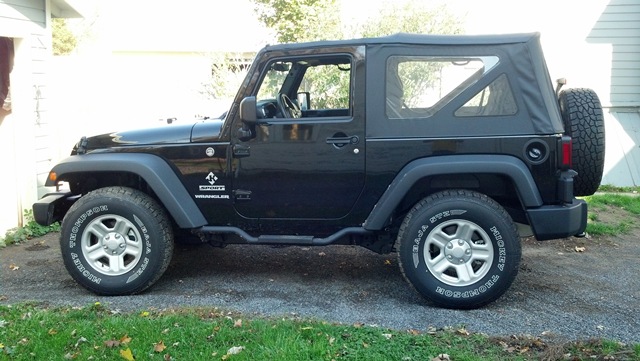

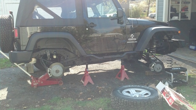

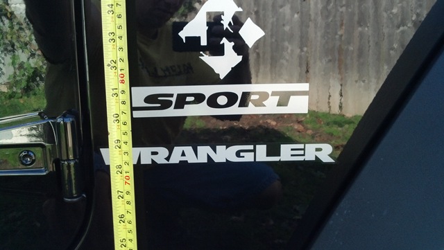

Default Lift Install complete
First - As per the instructions, it says that I must adjust my draglink to center the steering wheel prior to driving. Perhaps Im missing something, but my steering wheel remained centered? How do I adjust this properly? I took it for a ride around town last night and didnt notice any wobble. Is it always a Must that this gets done?
The overall install took about 8 hours for me. The first side took about 5 of the 8, as it was my first lift so I was really taking my time with things. Throw in a lunch, couple beers and just no need to rush, and that's about where I was.
I would say having two hydraulic jacks would have been helpful, as I used the factory scissor jack for the axle lifts to remove tension and my 3 ton hydraulic to keep the vehicle in the air. I also found that I was back and forth a lot with the jacks trying to find the best location. This was minimized on the second side, as the first side was the learning experience of it.
My first thought last night was that it felt a little top heave with the steering and it felt like it swayed back and forth more. I'm guessing that's due to a change in the center of gravity. I've got some 1 1/2" wheel spacers coming that I think will help, and Im sure it's just because I'm not use to it being that high up. It is however a smooth ride then I got with my factory suspension.
