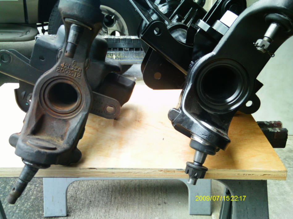

We've had ZERO issues with RCVs, ProSteers and ProRock 44 housings. With factory housings, it's a different story. We've had customers with factory housings that found, after a quick measurement of the gap between the factory ball joint and stock Rubi u-joint, the 'C's so badly bent, even with gussets (bent before install?) that ProSteers would interfere with the RCVs. Fortunately, these customers found the bent 'C' before they purchased ball joints or shafts.

When I talked to the RCV guy he told me the Prorock C's are very stout. 1 thickness of a paper match pack would be good, 2 would be better. I wouldn't think twice about this combo, it costs money initially but is smooth and trouble free. Throw some Reid Racing high steer knuckles at it while you're spending.
