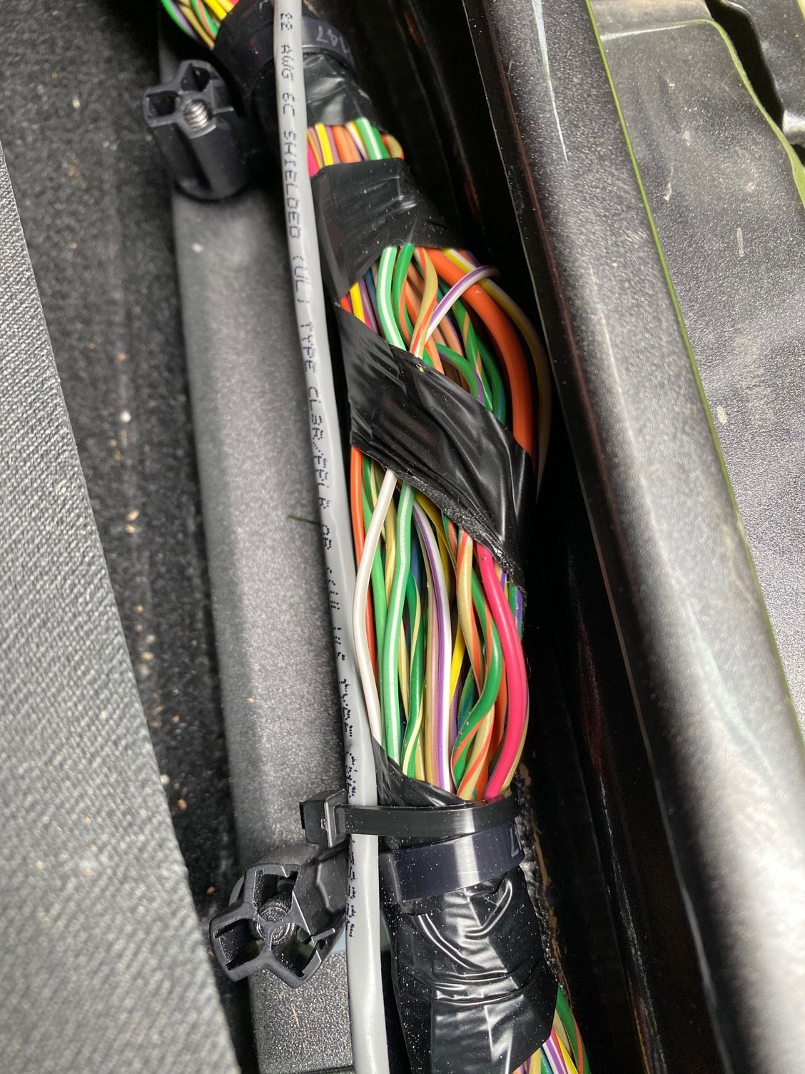

This is the '17 JKU Hard Rock wiring harness in the passenger side kick panel. The white wire with the grey stripe(left side) is the reverse wire

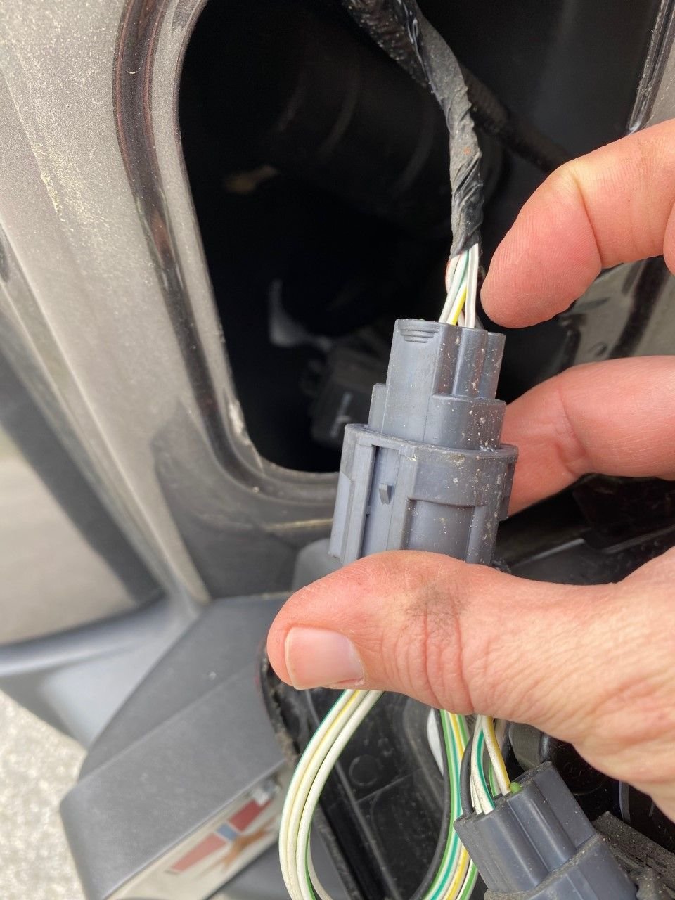

This is the rear tail light wiring harness with the same white wire with the grey stripe (the reverse wire)

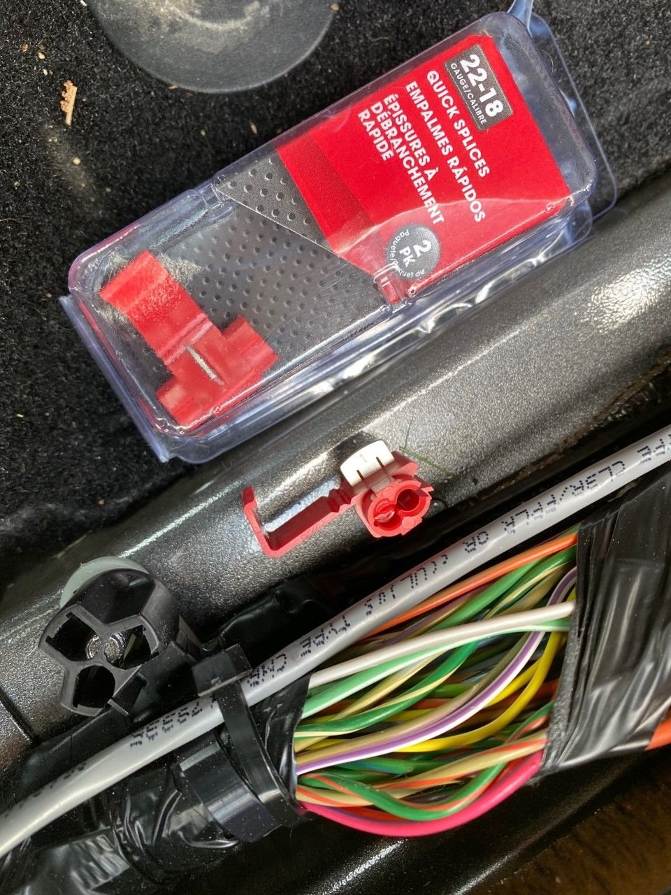

The "quick splice"

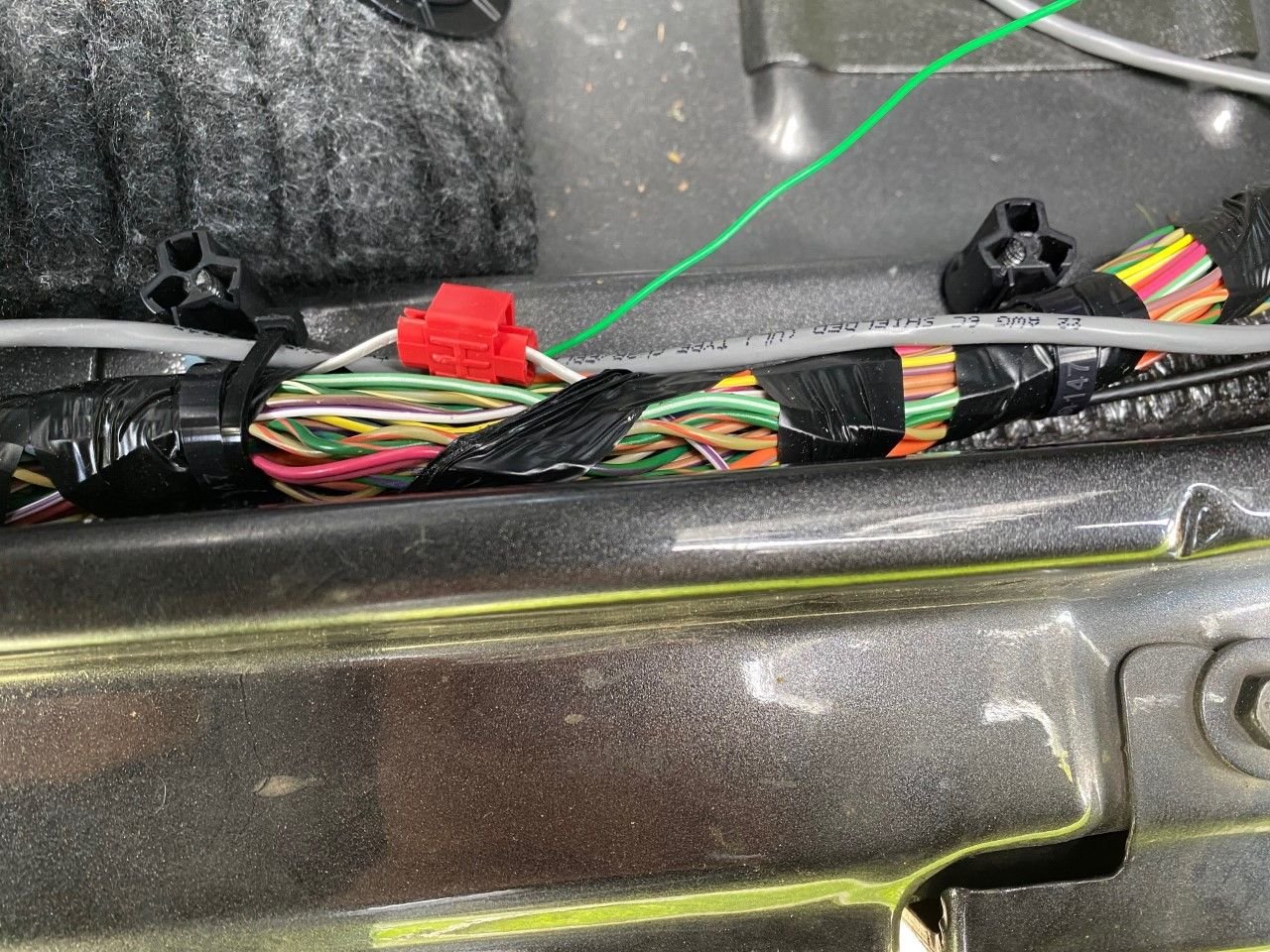

Finished quick splice on the passenger side wiring harness. Quick splice attached to the white/grey wire and the camera's green trigger wire (Insert both wires before closing the quick splice clamp).

It's been my experience that this type of connector has little corrosion resistance. Too much exposure to moisture/salts can make the electrical connection fail. My preference is to solder.
