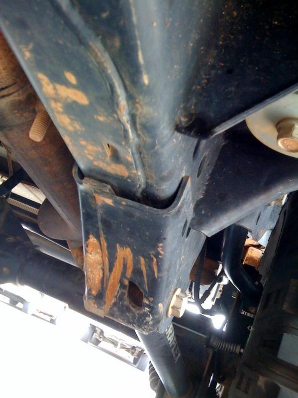

the rocks are starting to crush this mount into the control arm
Does anyone make a pc that could be welded to the rear lower control arm BODY mounts to protect them from getting crushed?

This...
http://www.offroadevolution.com/stor...p?prod=EVO-RCS
...and this.
http://www.offroadevolution.com/stor...?prod=EVO-1038

Indeed, get the EVO RockStar skids. They relocate the lower shock mount up about 1.5" (adds 1.5" of clearance) and adds a skid to the bottom of the control arm, plus, boxes the OEM mount to be a crapload stronger.
Does anyone make a pc that could be welded to the rear lower control arm mounts to protect them from getting crushed?
EVO does.
Front
Rear
They also have a more expensive rear bolt on that relocate the rear shock location.
I have the weld on front/rear personally.

Default sorry - clarified - the forward body mount - not axle end of control arm
