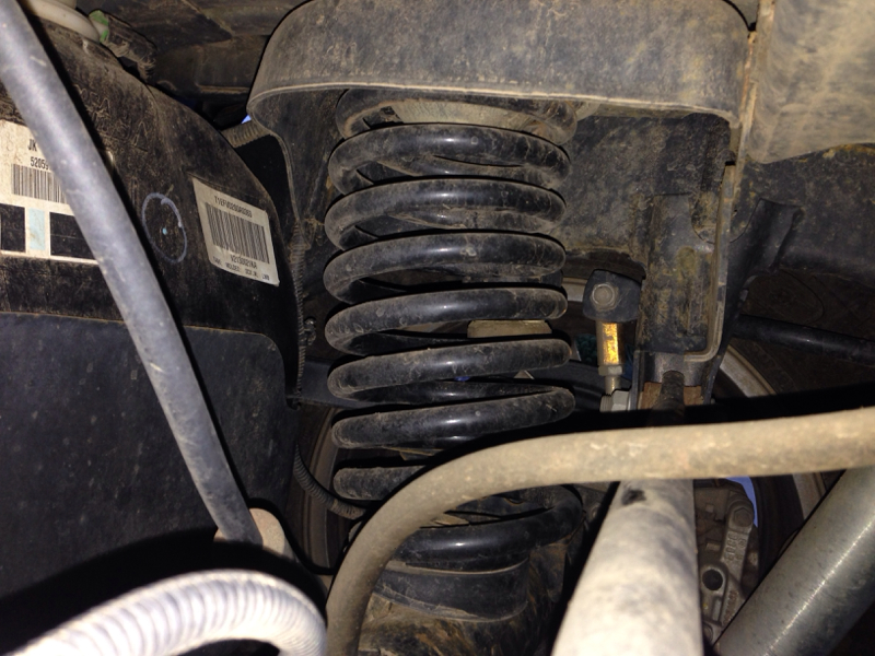

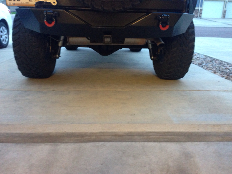

So I measured a 1/2" sag on the passenger rear. I have the RK coil correction wedges and RK 2.5 springs. Lift was installed professionally 1 1/2 years ago. The spring seems to be bowing forward. Any ideas?
Attachment 621935
Attachment 621936
pretty normal. i have the same. wedges and all.

What lift you running? Do you have the control arms as well, ie rear end moved aft 1"? If so, a wise investment is to rotate the perches and easiest way is with the JKS kit. Looks to me like they're bowing aft as expected.
I've also found the new triple rate springs are VERY soft and I even went back to their older linear springs for that reason. Not to mention, a full tank will have some effect.

What lift you running? Do you have the control arms as well, ie rear end moved aft 1"? If so, a wise investment is to rotate the perches and easiest way is with the JKS kit. Looks to me like they're bowing aft as expected. I've also found the new triple rate springs are VERY soft and I even went back to their older linear springs for that reason. Not to mention, a full tank will have some effect.
The lift is RK 2.5 max travel with LCAs. I'm at about 3/4 of a tank so might be a factor....
I believe these are the old RK linear coils due to the time frame I got the lift so I'm not sure why they seem so compressed. Guess these things are to be expected when you start modifying the geometry of a vehicle.
Sent from my iPad using JK-Forum
Well, looking at them again, you may be right about linears. Some things can be expected but I wouldn't like it either. Mine sags 1/2" with full tank which is hardly perceptible. I only know it because I've measured the rocker panel. (I have the 3.5 max travel) I would look at 1 of 2 options: cut the perches and reweld or install the JKS kit which allows you some room to play with perch angles, and/or get new springs. If your springs are contacting the trackbar, you need to rotate the perches anyway. The wedges did little for me.
I would also try running the tank empty and then swap springs to see if the sag follows the spring. If so, you know you have a weak spring but I've not seen that often.
