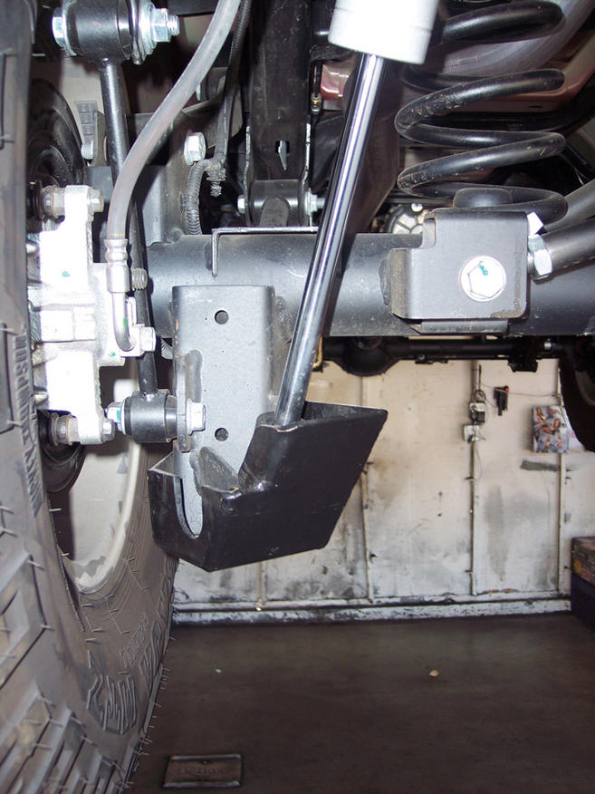

Curious what everyone is doing with their rear lower shock mounts. Mine are starting to take a beating. Not only are the mounts getting hit, I have the Rancho RS9000XL manually adjustable shocks and I'm breaking off the knobs. Here's a picture of the "good" side with some minor bangs and a busted knob:

I can find two options: protect like with the Kilby Trail Boss shock skid, or move up a bit like with the Treks brackets.
Relocating would bring the shock up some (but not completely) and offers a bit more ground clearance. However, relocation impacts the compressed length of the shock.
Protecting would help keep the shock out of harm's way, but the skids would need to be modified to allow adjusting of the shock. Also, the skids hang down even more, even if it's just 1/4".

Well, I think you answered most of your own question...but, I think I can add that a remote adjustment accessory from rancho may allow you to adjust the shocks from the cab...that would allow you to use the skid and an inverted shock mount more conveniently.
Another option is to actually check the shock length on full stuff, and see if there is any room to compress the shock more, as in, if you were to raise the lower mount, would the shock still have room for full compression.

I have the Kilby Shock Skids, they are nice, and well built. Although If I had to do it again I would do the relocation brackets from one of the other companies offering them.

Myself I would go for the rock guard and lose the 1/4". Reason being is that it is right next to your wheel, so close that when rolling over a rock it should not be an issue.

I put the relocation ones on... cut off a good 1.5" but still hit the rocks occasionally, but I definately like the extra clearance.
I have the AiROCK system, which has spacers for the replacement shocks... just removed them and had a perfect match up to the middle hole of the relocation brackets.
I'd recommend the relocation brackets... plus it's always fun cutting off steel that gets in the way.

Here Is our new EVO Rock Star Rear control arm skid it raises your shock and gives you about 2 inches of ground clearance and provides a lower control arm skid all in one
