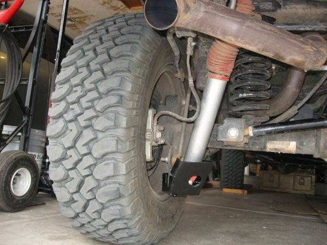

Just thought of another down side - also probably need longer brake line extensions.
I would like the ground clearance, but I'll use the stock location and protect it for now. Here's a shot of my solution. I had to cut out a hole so I could get at the shock adjuster. I like this solution because it protects the adjustment mechanism too. Moving it up would help some but still leave it exposed.
Attachment 17094
Yep, longer brake lines are also a good idea. (I already have those)
That is a nice skid there! When are you going to start selling them?
I'd like to take credit, but they are the Kilby Trail Boss JK Shock Skids. The custom Shock Adjuster Hole is my only contribution.
Did find out the skids also work well as terrain sampling scoops. (tends to collect mud)
