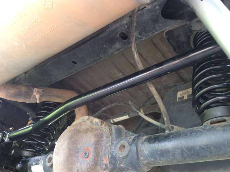

The max travel kit comes with a relocation bracket and an adjustable rear track. I would say you would need to install both.

I'm sorry. I misread. I thought you had the X factor.
