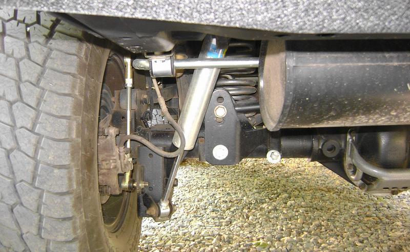

I've heard the stock axle side of the track bar mount is prone to breaking/failing mainly from extreme articulation and hard off road use. Another option is Tera Flex's HD bracket, mounts to stock mount and around the axle for a strong set up cutting out the weak link of the stock mount, very happy with mine
