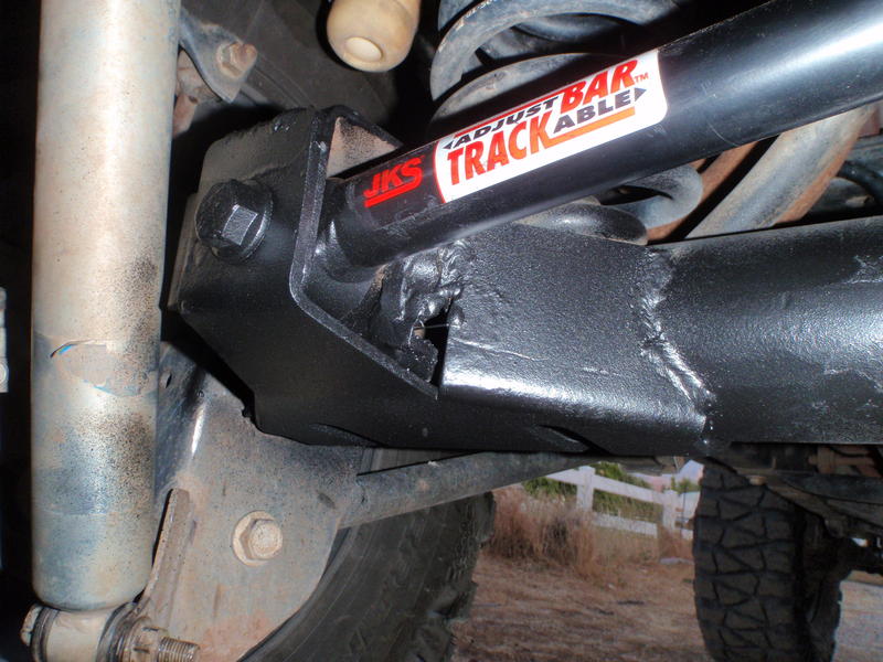

Ive got the adj JKS on the rear with the brace as well. Its at the same highth as stock and ive got a 4 in lift. Works good for me.
