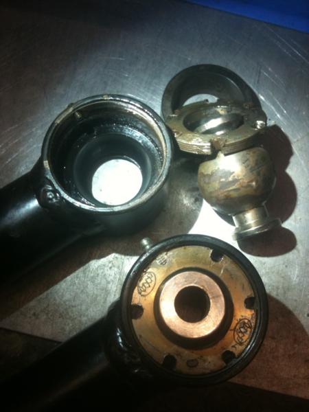

Who has parts?
Treaded lock ring is done.
Is there a torque spec for the joint?

I checked with Currie they have the snap ring for a clip, these have a tread in lock ring and cupped washer. My uppers are Currie but these lowers have no stamp. I'm trying to ID them.

Those are Summit Machine joints, they are located in Draper,Ut. They do have a website.
Thanks, that is great and makes it all work.
Nice products, I can make it work with that.
