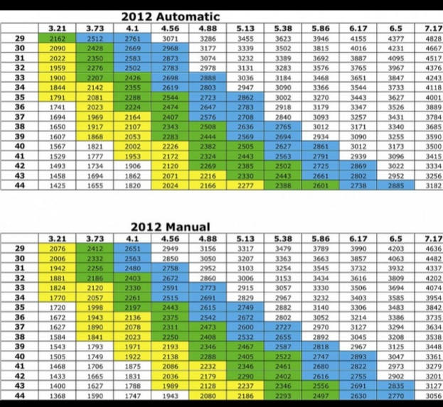

You'll want to reference that for the suitable gear ratios depending on your future plans...

Originally Posted by Atlacatl
<img src="https://www.jk-forum.com/forums/attachment.php?attachmentid=403912"/>
You'll want to reference that for the suitable gear ratios depending on your future plans...[/QUOTE]
He drives a 2010 with the 3.8. These charts are for the 3.6

Here's the correct chart for the 3.8
