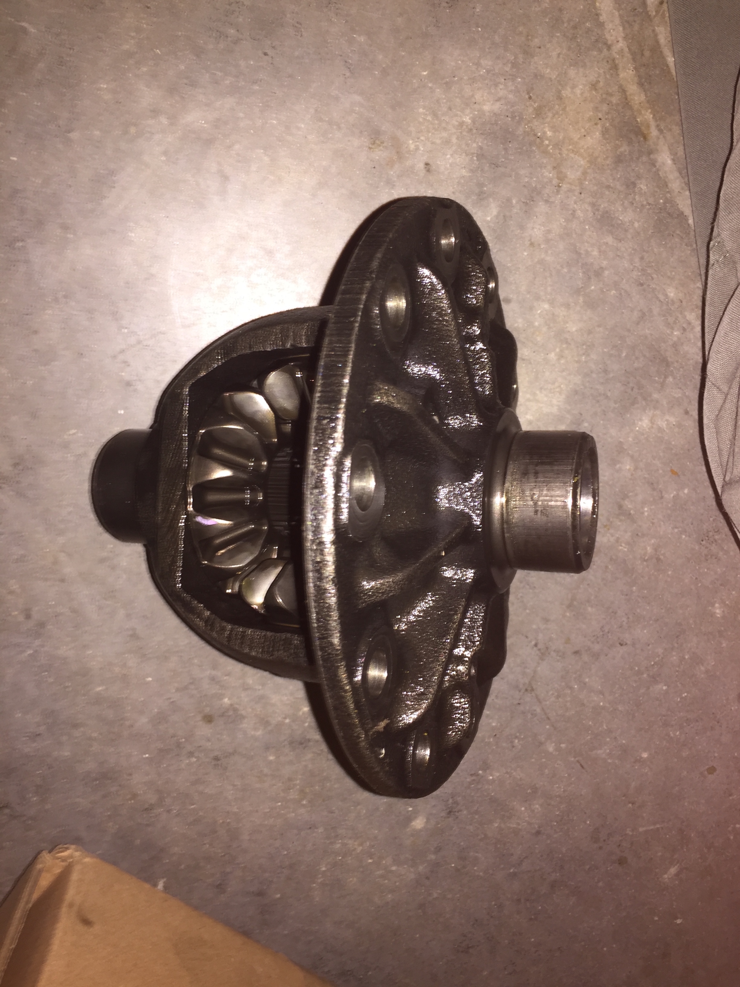

Loaded carriers cost around $200 or less. An E-Locker carrier cost around $900 for the rear and $800 for the front. I gave my front open away to a friend that blew his. But I do have a Rear 44 open loaded with 9K miles on it.
*Edit*
I'm going to list it on Ebay I'm only a (106) but I am a Top Rated seller

Just a heads up, the rear is good for any ratio it's only the front that had the ratio split

Yep your right he only needs a front
