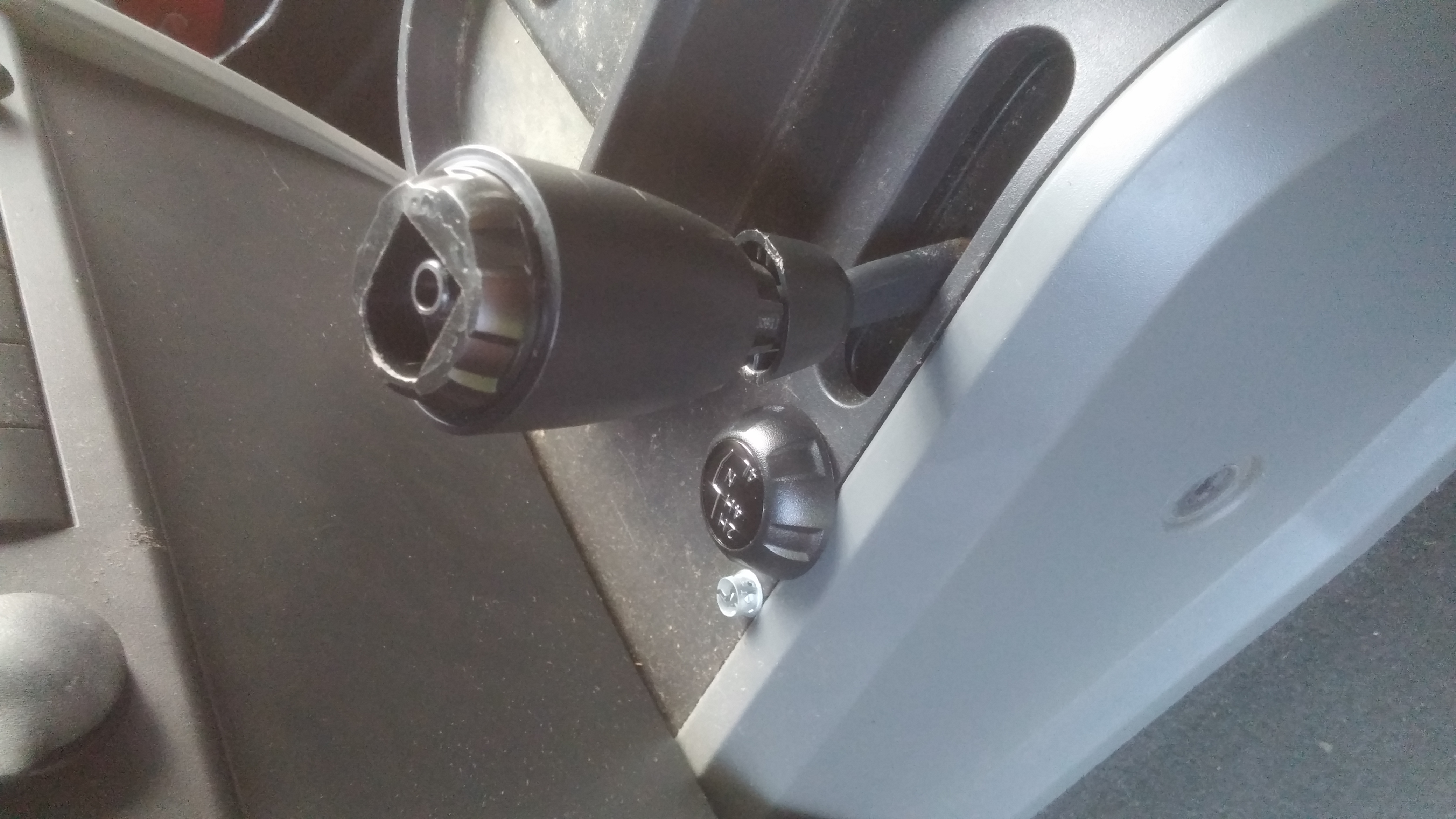

I need to know how to take this knob off, I already took some pieces apart. What now?

You're best bet is to go to YouTube and look up 'how to remove jeep jk 4wd knob'... there's a bunch of different methods.. YMMV...

Your'e going to have to literally pull it off. Be careful you dont punch yourself in the face when doing so lol
A lot of people have had luck with wrapping a cloth/towel under the knob and pulling it off that way

Are there any tools that can help? I'm having trouble with brute force at the moment

A strap wrench worked for me...
https://www.youtube.com/watch?v=10b_EzYbmxw#t=10

Use a crescent wrench...
Fit it to the shaft just under the knob then smack the wrench with a hammer.
Short of a slide hammer, best method I've found so far.

the method i used. just put some tape on the shaft so you dont scratch it up.

Shift it into 4lo and pull it off.
Done.
