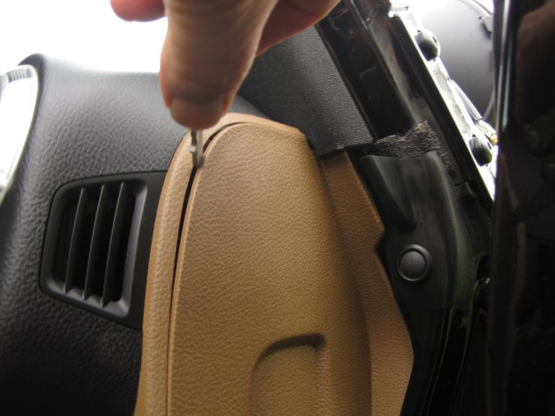

I've spent the last hour searching the forum for the answer to this, obviously the google-fu is weak in this one.
I need to get into the dash to wire some windshield lights. I can't seem to coax those panels off without fear of breaking them.
Is the 2011 different than earlier models? What exactly hold the panels on?

from what I have read, you turn the vent bezel 1/4 turn and it comes out. Then on the passenger side, you just reach in and push the side out. I will get a thread where it is better described in a min....

just clips, use a small screwdriver and pop them out

I know the 2010/11s have a redesigned interior. but for my 09, I take out the side air vent, when its out try sticking your finger through there to popoff the side panel

the 2011's you dont' need to just open the door (if they are on and pop the side piece off

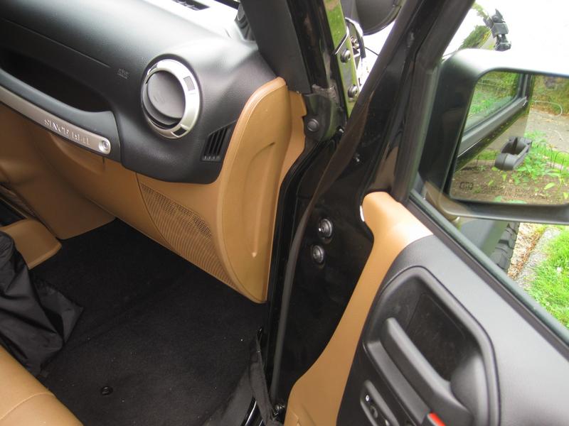

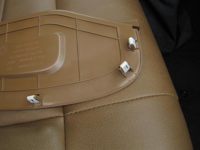

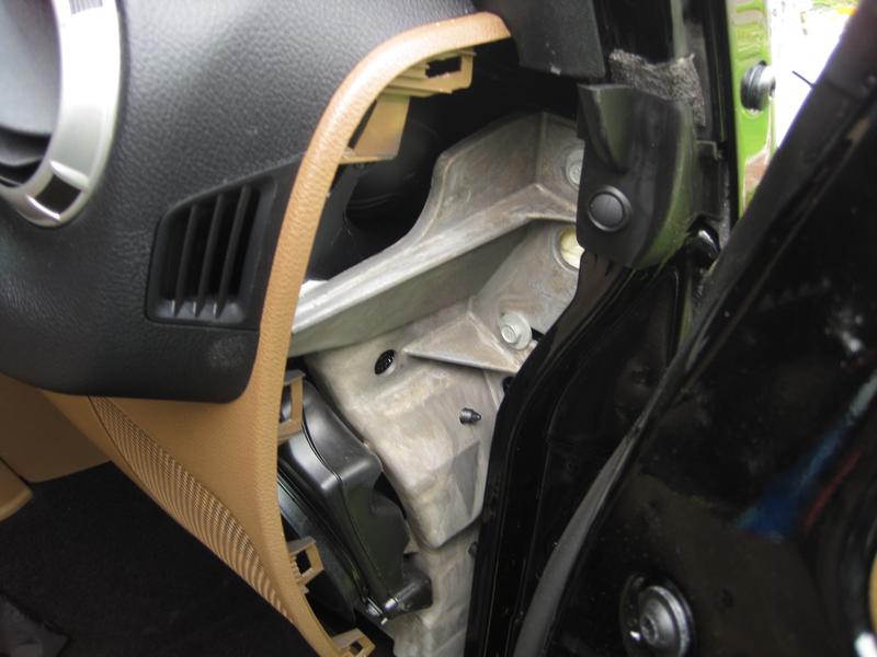

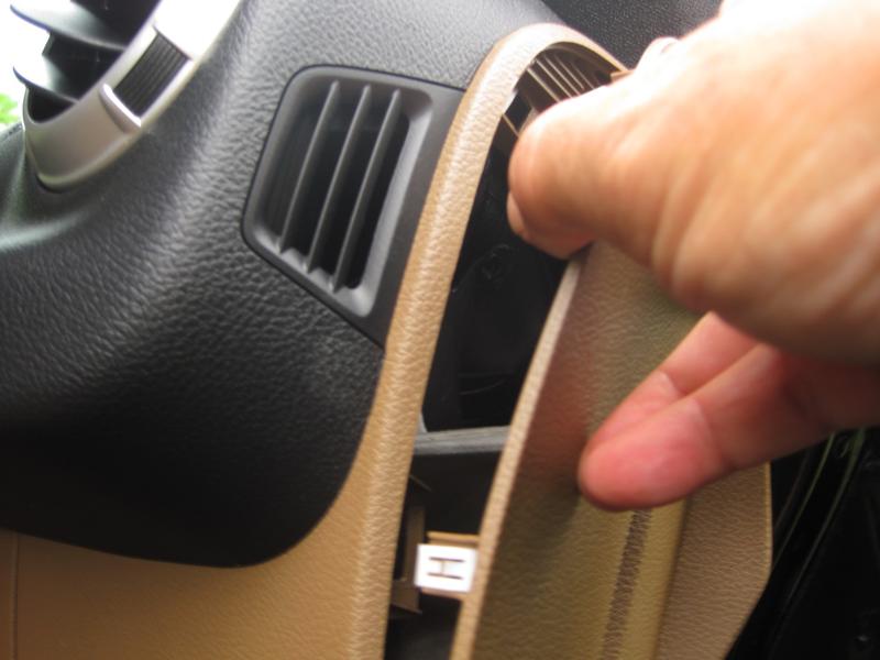

Thanks guys, I figured it out. I took some pics so the next person searching might find this.
