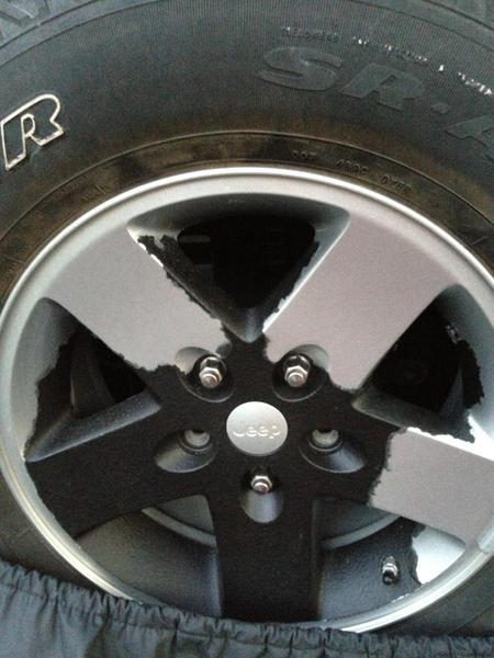

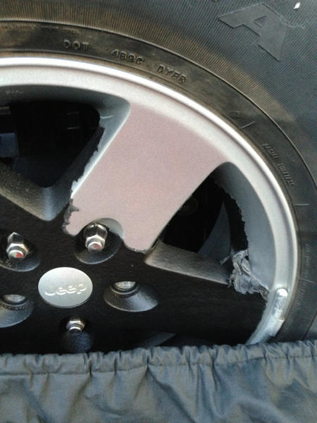

can't seem to get it all off without a battle. any tips or suggestions? paint thinner etc?

Haven't done it myself but I would imagine a pressure washer will take that right off without ruining the finish. Good luck.

Try to peel the rest off by hand then you can take a micro fiber towel and rub the wheel to get all the little excess off. Next time you use plastidip make sure you apply about 5 -6 coats so it is thick and then it should come off in one piece.

Okay thank you so much guys, I'll try it! and paint thinner won't ruin the finish will it?

It shouldnt but there is really no need to use paint thinner

Applying some heat to it I find helped in doing mine.

Power washing, goo gone, and gasoline just to name a few ways.
