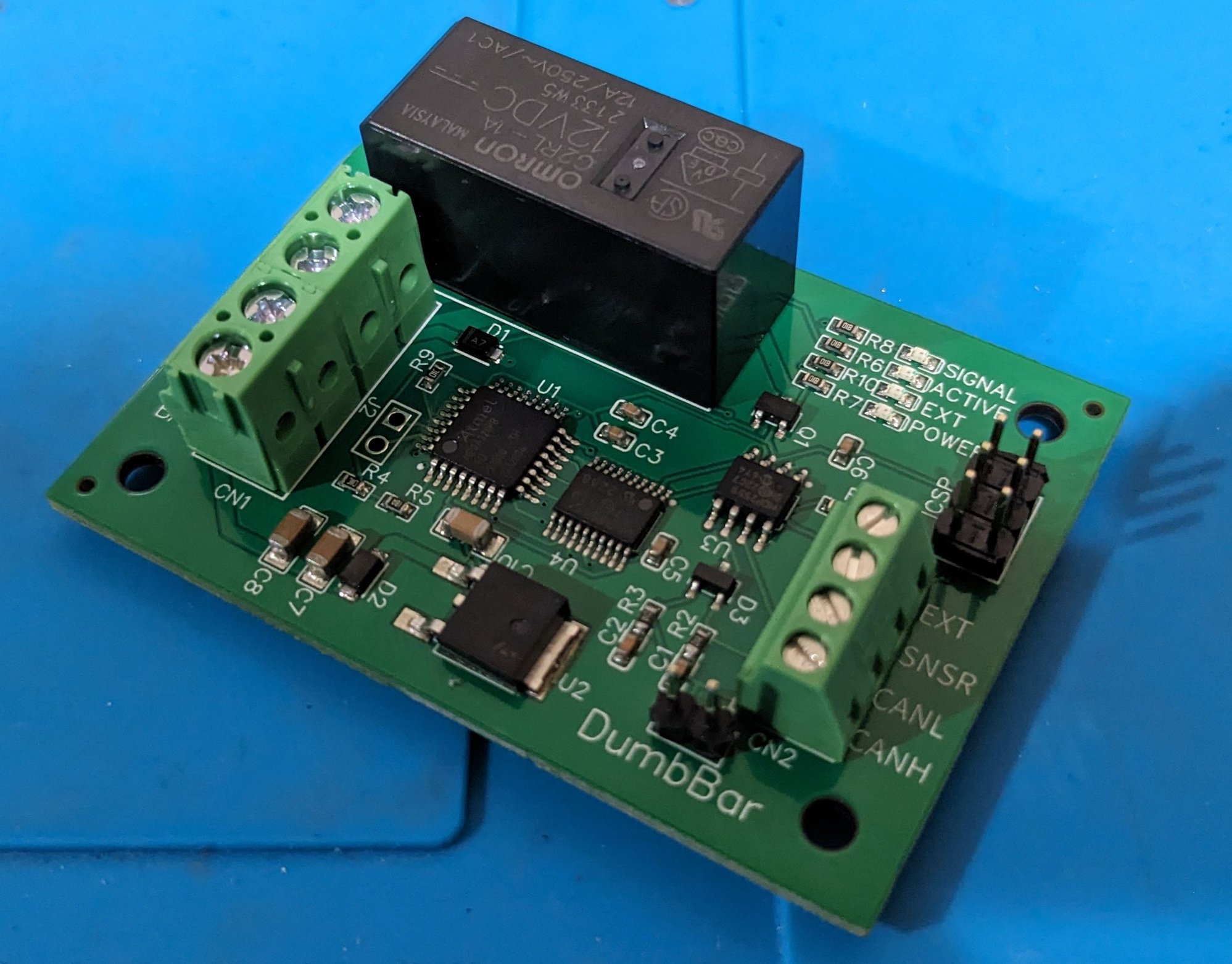

So, after a bunch of work, I've got a prototype module that looks like a SmartBar to the vehicle computer. It allows you to operate your aftermarket disconnect (or anything else really) with the factory button, and it also controls the dash light so that it's illuminated when the disconnect is engaged, like it's supposed to. It works in 2WD and at any speed. It remembers its state across starts and doesn't disconnect until you tell it to. It was an opportunity to not only solve the problem but also improve over factory.

For anyone interested in the device itself, it's a little microcontroller with CANBUS hardware and a relay. It talks to the chassis to keep it happy (keeps it from going into error state and blinking the light), toggles the relay when the button is pushed, and controls the light in the instrument cluster. Since it's just a relay, you could technically control anything with it (despite the label on the button) and I can put it into a mode where it never turns on the light but continues to toggle the relay, if it's used for something else.
It really just needs two things from the factory harness: the two CANBUS wires. Those are accessible elsewhere on the vehicle, but they're most handy where the factory SmartBar connected. It also needs an ignition-switched 12v wire and ground, both are also accessible in the factory harness.

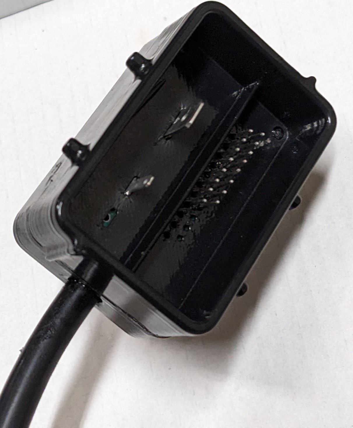

I also made a 3D-printed male connector for the funky smart bar harness so I could interface with my factory wires non-destructively before I was sure it would work. It's a little over the top, and probably not worth doing for everyone, but I think it's pretty cool
