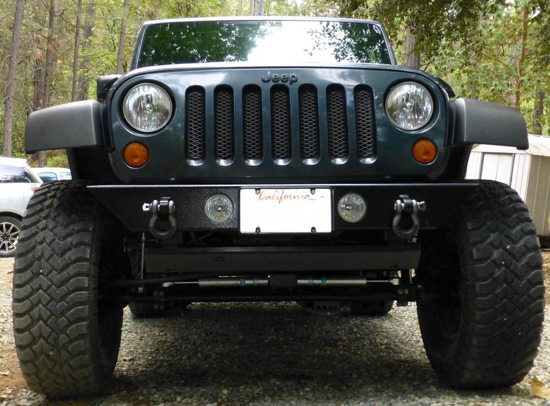

I'm really happy with Bilsteins
Attachment 391106
Which dual bracket are you using?
Old Nov 21, 2012 | 06:31 PM
k0260's Avatar
Posts: 5,234
From: Nevada City California
It's a Rough Country mount set up, I replaced the crap RC 2.2 stabilizers for Bilstein. With that mount, you could use Bilstein, Fox, many others that perform better than what RC delivers.
