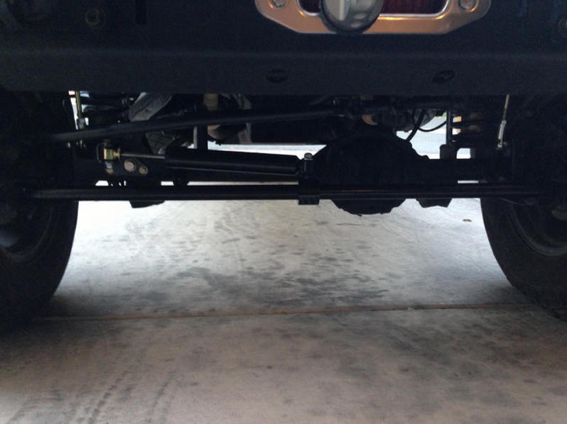

I'm running the synergy SS and relocation mount
Old Nov 22, 2012 | 12:27 PM
Tanner6427's Avatar
Posts: 437
From: Las Vegas, NV
Here's a pic also

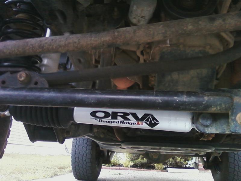

MiJKguy's Avatar
Posts: 182
From: Grand Rapids Michigan
Default Rugged Ridge ORV
ID:	391323 love it! it's like night and day
