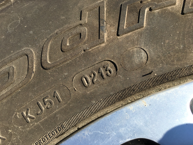

Check out the DOT date stamp on the tire, and see when it was made. If it is more than about 5 years old, you might be better off just keeping it as an emergency spare. Date stamp looks is 4 numbers inside an oval, the first 2 tell you what week of the year it was made, the second tell you what year. For example: the one shown in this picture was made in the second week of 2013.
Happy Jeeping!
