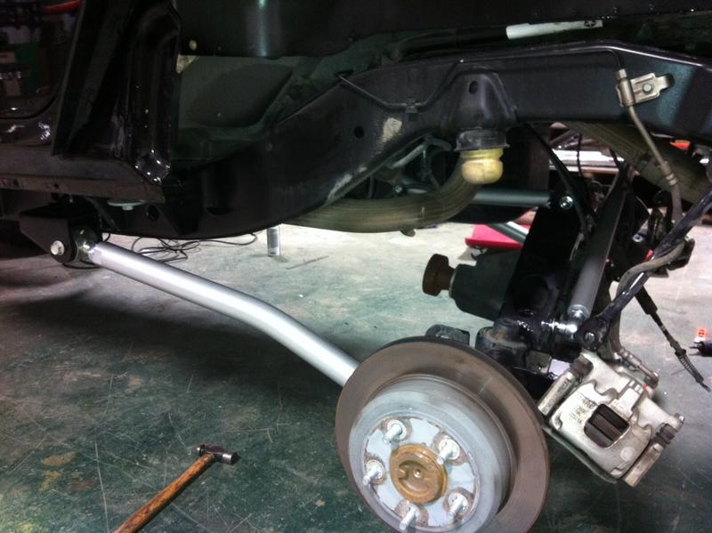

Rear links are in. Almost there!!!

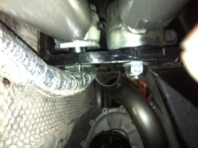

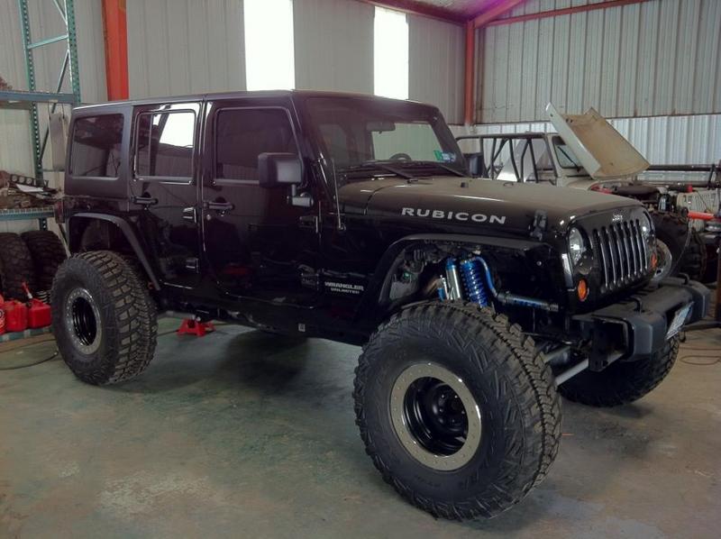

Well she's sitting on all fours now, but had some more issues today. The fox shocks I ordered for the rear are for a 4" to 6" lift. I was told to order those shocks even though I had a 3.5" lift because I'de get more droop. Well since my lift kit relocates the rear shock mounts up about 3" there is not enough up travel now. I'll be replacing them with OEM 2.0 Kings. The fox shocks will be listed for sale soon so keep an eye out.
Next, the AEV Y-pipe with loop delete does not just drop in. The loop delete pipe fits fine. The section that moves the cross over pipe does not fit with long arm brackets. Dave is having to cut up the AEV pipe and the stock pipes, like a jig saw puzzle, and try and make this shit work.
Here she is on all fours, and here's a pic Dave sent showing how tight it is with the long arm brackets.
Name:	exhaust clearance.jpg
