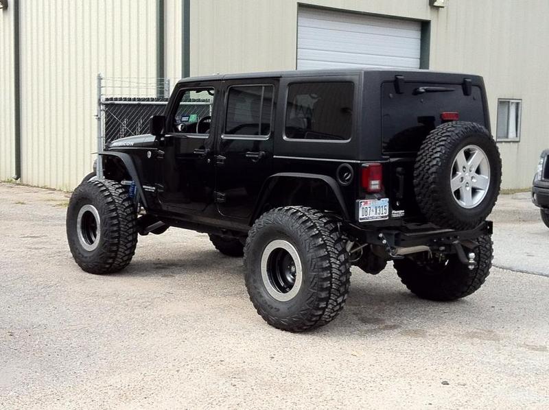

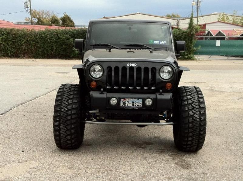

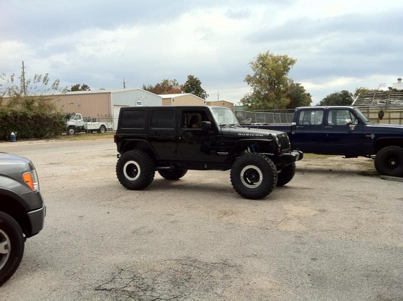

Picked the jeep up today. Still have a lot of minor things to do. New rear shocks, rear bumps, steering stabilizer, flex it, and dial it in. Got a little bit of tire rub on the bypass shock at full lock. After we flex it out we'll put some steering stops in.
Left the shop and went straight to discount tire to get the tires balanced. I'm very impressed with how the ride was. No steering stabilizer, couldn't really tell. Tires had a slight vibration only at 65 mph. Got the tires balanced and that was taken care of. The front is riding a little stiff, but I'm pretty sure that's because Off Road Evolution calculates the added weight of a steel bumper and a winch when they valve their double throwdown. I'll wait until I add a bumper and winch before I change anything up.
I was really pressed for time today and didn't get very good pics, but here's a few.

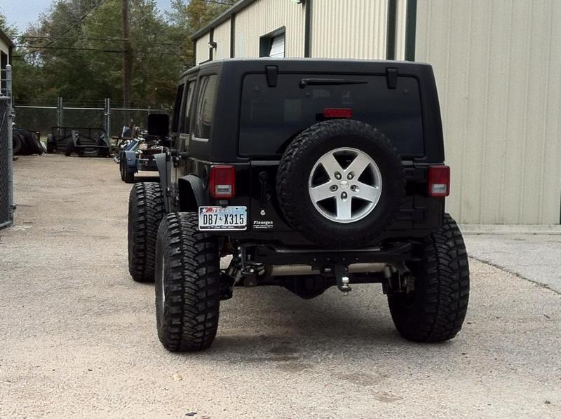

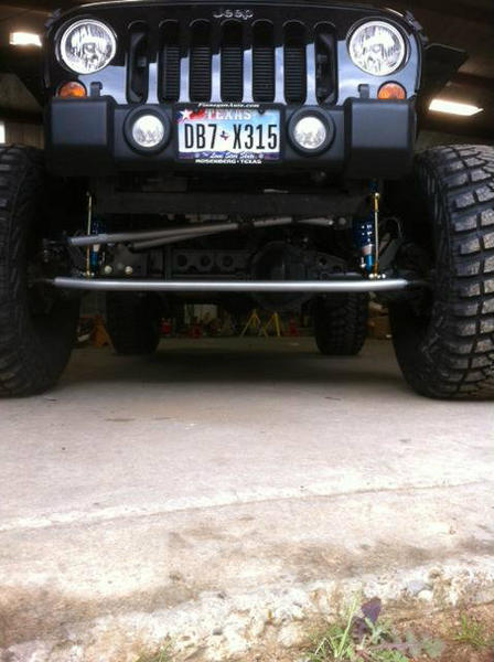

Here's a few pics Dave took.

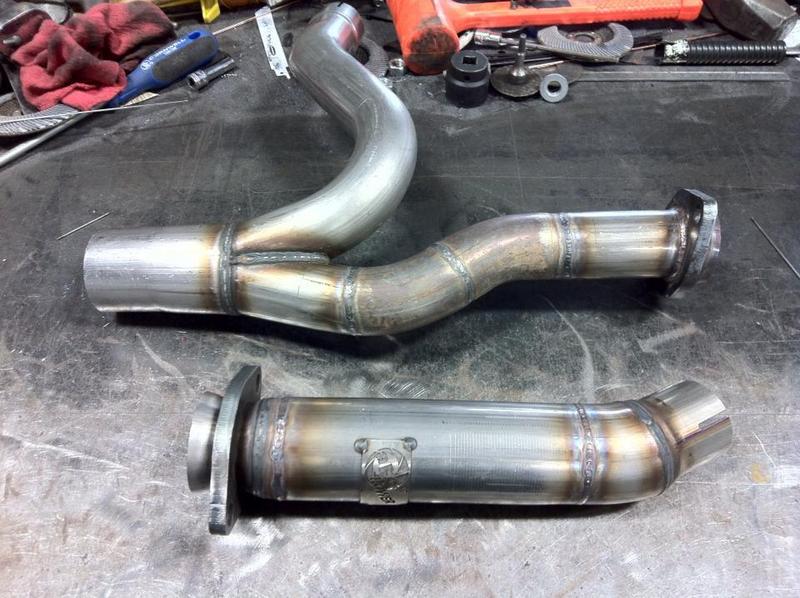

Here's my modified AEV y-pipe w/ loop delete.

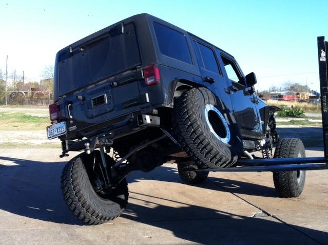

Finally got to cycle the suspension and trim the fenders wells. Looks like I'll be ordering up some 4" bump stops for the rear. I also changed out the rear fox shocks for some kings. I started a for sale thread for the fox shocks if anyone is interested. They only have 800 miles on them.
