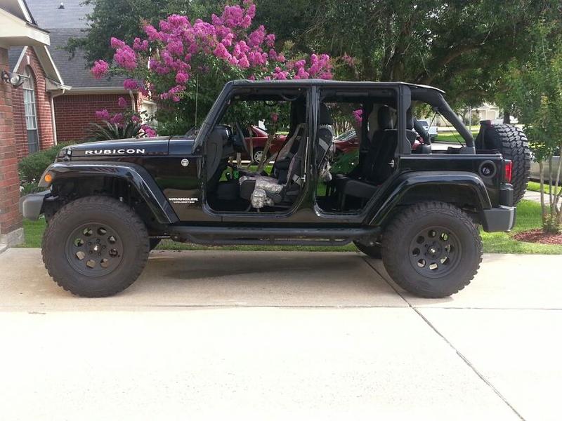

I put on their 2.5" max travel kit, has the 2.5 coils, my front end is 1/2" higher than my rear

Perfect. Do you have any pics?

there she is

the front will settle a bit.. im thinking when i put on my front bumper in a couple weeks ill be rolling level. when you first put them in you will have a reverse rake for a bit till the springs settle

You definitely do not want to install the 3.5" springs in the rear. That would make you sit so uneven it isn't even funny. Give it some time to settle and you will be happy.
You must be a busy man since you haven't gotten that bumper on yet lol. The bumper will definitely help level it out.
