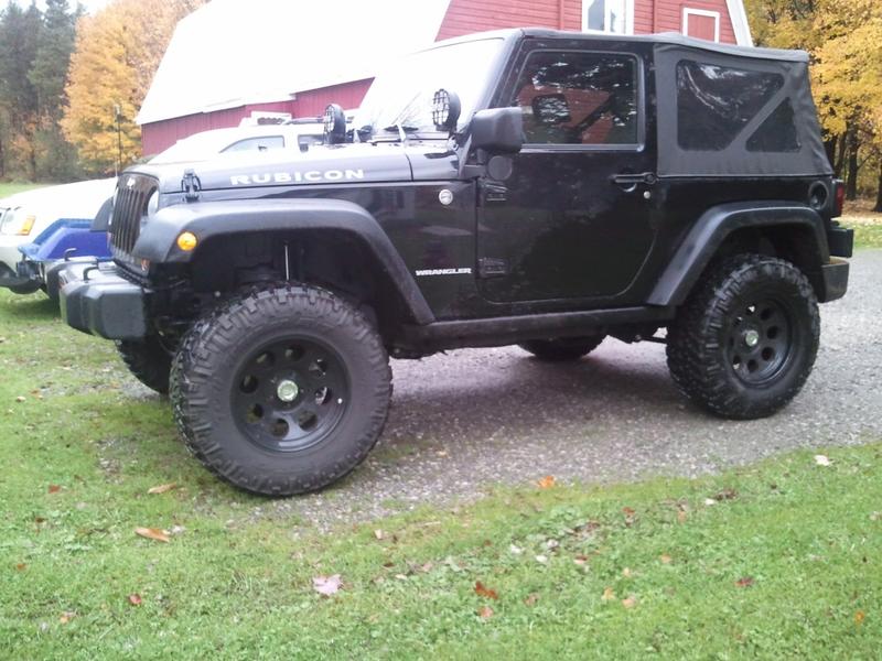

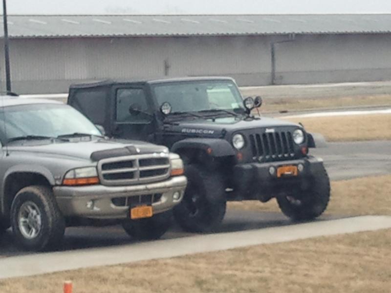

2.5" Tera Flex (4dr lift) Bilstein 5100 shocks + RC 3/4 coil spacers - total lift is around 4"
Rides great. I have geometry correcting brackets for the front oem control arms... but I have not yet installed them.
I don't have any pics since the 3/4" coil spacer install, but here it is with just the 2.5" TF lift.
do yourself a favor and get the heavy duty front track bar from TF too... it's perfect. one more note, I have my track bar re-torqued by the dealer with every oil change... 1. security on my end 2. keeps the dealer happy with my lift - they are good with my warranty since I am having them keep an eye on the suspension.

It looks awesome! What size are those tires?

295 70 17 - 33"
Planning to go with either 35" tires or install the 1" body lift I have and go with 37" tires this fall.
