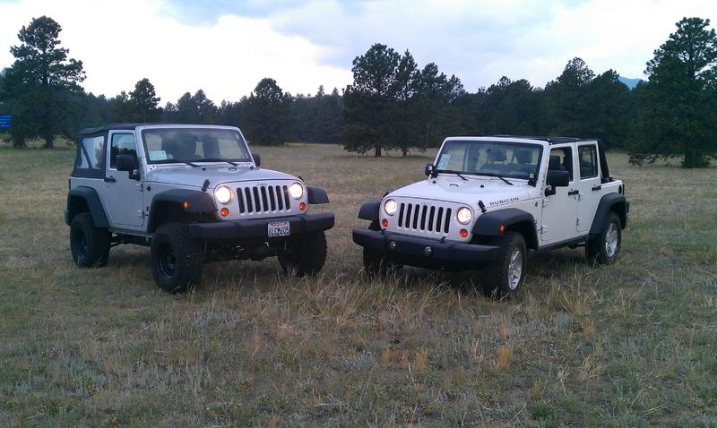

sorry i didnt take hardly any pictures but here is one of the finished product (silver 2 door on the left) and as you can see 31s are a bit small for that lift so hopefully i can at least convince him to upgrade to some 33s
