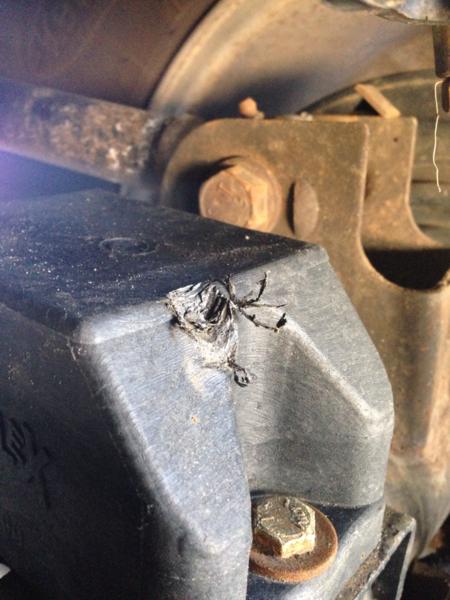

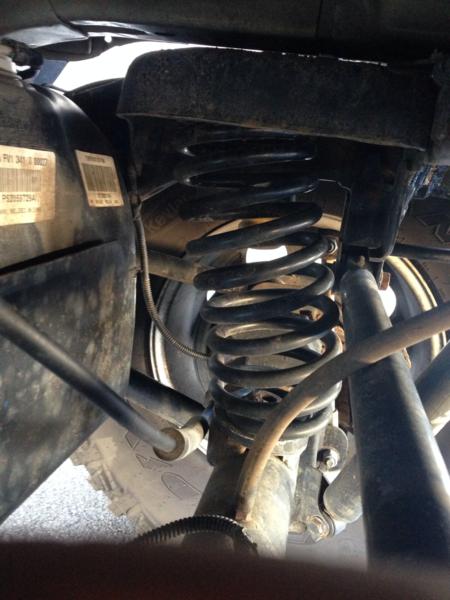

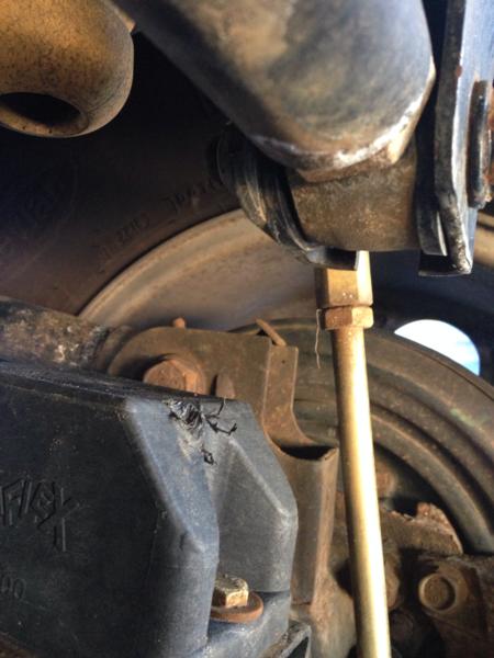

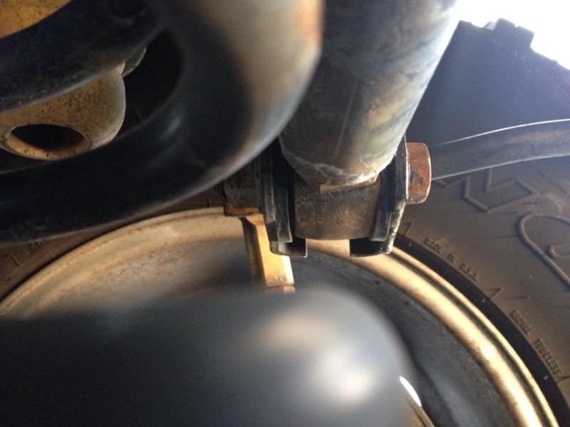

Hey guys. New question. I had a bit of weight in my rear last night with 3 guys and the tire carrier and spare. I was hitting bumps and my track bar bolt rubbed my bumpstop. Anyone know if this is normal? Also my rear coils are sitting real slanted. More than what seems normal.
