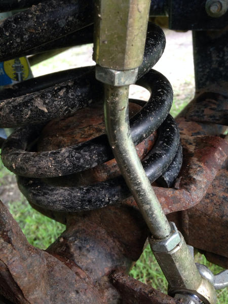

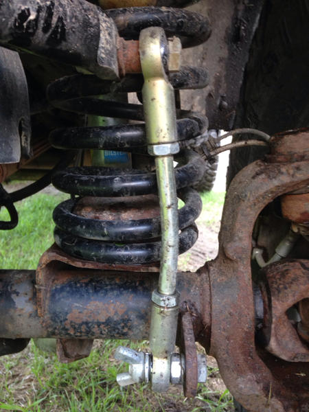

I have had my lift on for two months or so now and have put about 2000 km on the jeep since I installed it, all being road use. Today I took a look under my jeep to see this

Both sway bar links are bent, why would this be? Are gravel roads are really bad and unbearable to drive on but I would think a offroad capable lift would be able to take it could there be any other explanation for this happening?
ha thats great, how fast do you go on these gravel roads?

The max I travel is 40 the odd spot 60 kph, I just returned home the other day and hit a few holes pretty hard and fast not knowing the roads were so rough, I'm luck I still have all my teeth but blaming the roads is still a far fetched idea but I have nothing else to blame
