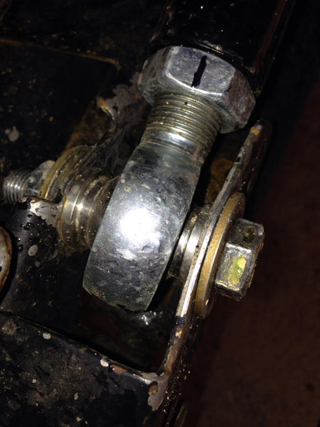

Does this look ok?

Does this look ok?
Looks fine. The only thing you could do differently would of been to have the heim joint straight but it can be difficult to do that and tighten the jam nut. That little twist shouldn't affect it movement at all.
Thanks, I had it straight but I guess it moved once I started driving my jeep.

I've had to re torque and adjust my track bar a few times. PITA to get the jamb nut tight enough.
thanks, ive gotten the jam nut as tight as i can get it and then just marked it to see if there is any movement, when i checked it today i seen the heim join like that and was just making sure that its not going to mess up or affect anything.

Check the nut on the opposite side. That's what caused mine to move.
