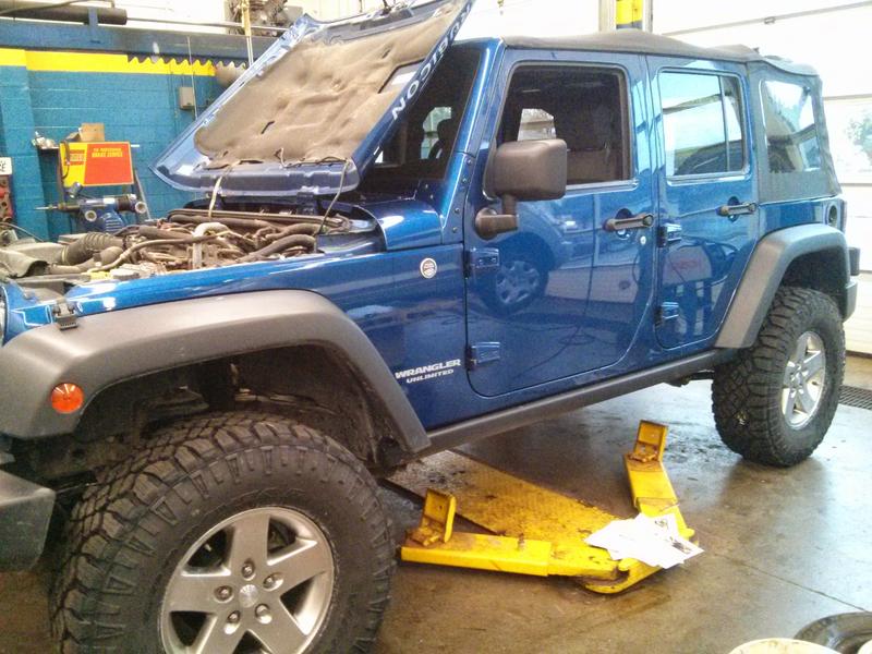

I have this lift. I also have the bilsteins, proper bumpstops and spring retainers but I went right to a 35" tire, though I am on stock wheels with spydertrax. The ride is great, absorbs rolls and bumps very well. I can say that during the winter (especially here in SW Ontario with -40c temps) the bilsteins got pretty harsh, though I am not sure most every other shock would react the same way.
The quality of the RK lift is top notch. All the parts are stout and as mentioned above, you will get more than advertised unless you're already outfitted with heavy bumpers, etc. I have a JKUR and did not have to change out my drive shaft.
I'll do some digging around and see if i can post up a pic for you...
Here ya go...
