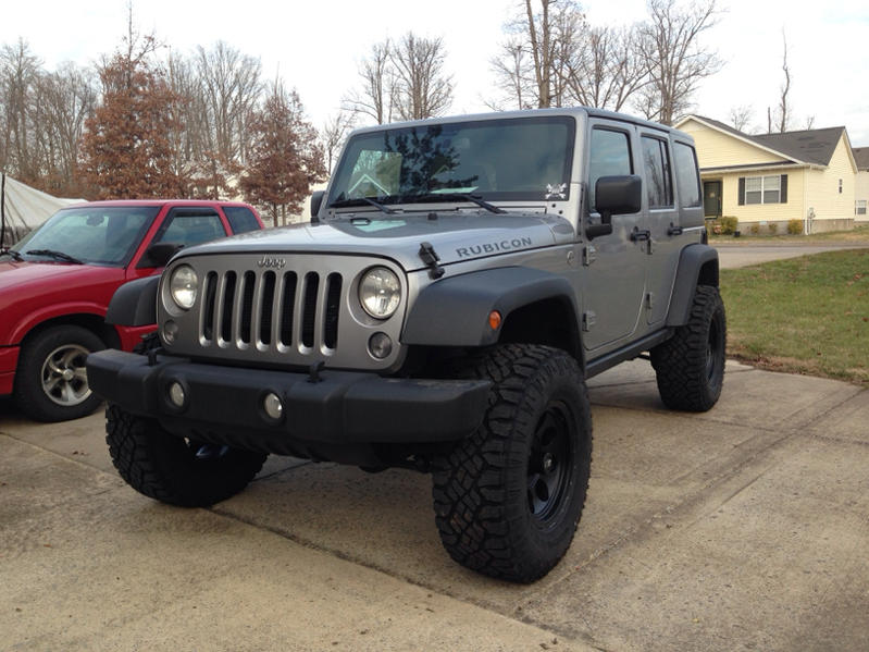

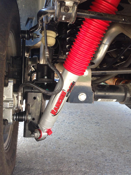

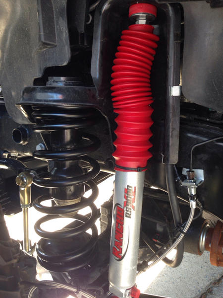

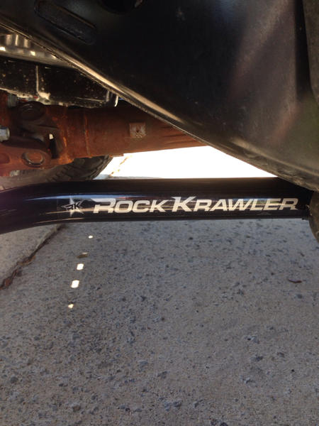

I have the RK 2.5 Flex kit with 35's on my 2014 4 door Rubi with Rancho 9000's and really like the setup. Click image for larger version

Thanks for the input...a lot to think about and scottkel I really like the look of your rubi

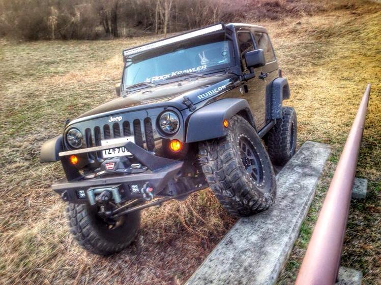

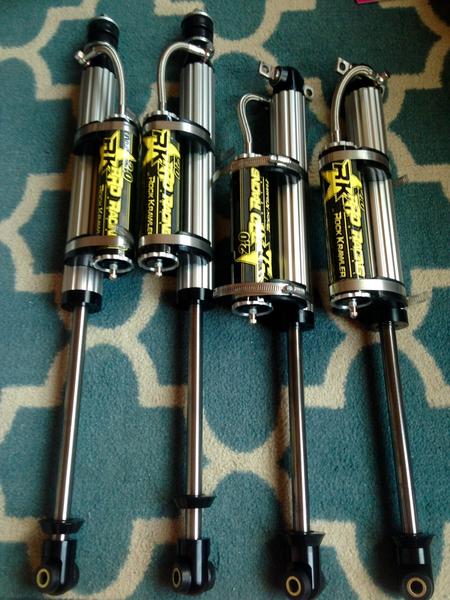

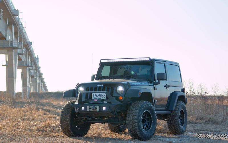

Default RK 2.5 Stock Mod
Stock Mod 2.5 with the RK RRD 2.0 Resi Shocks...also added a RK rear track bar. Planning on upgrading control arms down the road. Also went with RK's recommended 3in bump stops front and rear.
