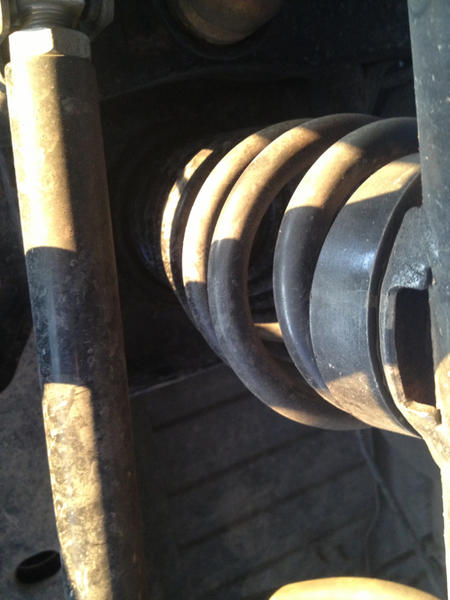

Here's my problems here
ID:	389421   Click image for larger version

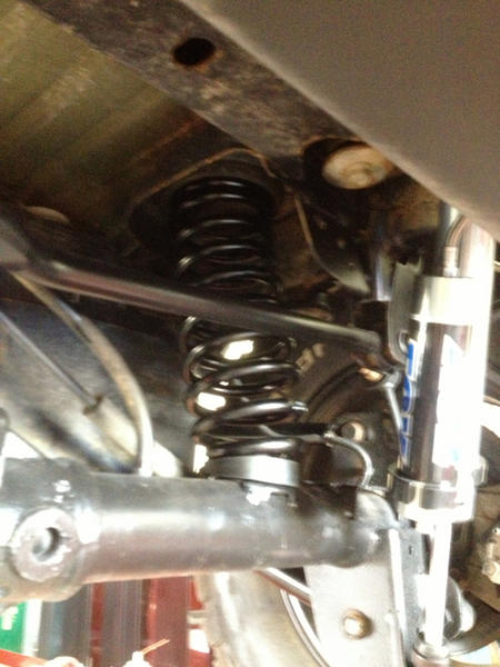

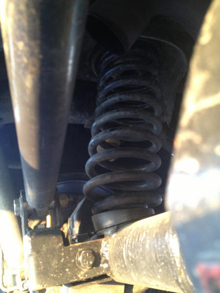

Here's how mine sit. Never had rubbing on track bar or shocks.
ID:	389423   Click image for larger version

Can't tell from your pics but you do have a track bar relocation bracket right? You can see the one I have in my first pic that is bolted and welded on.
