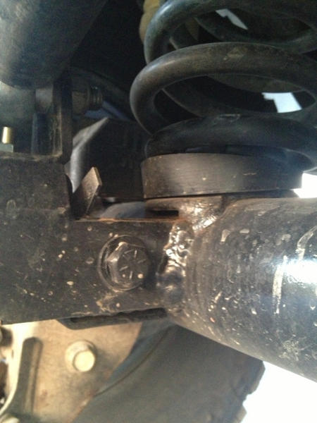

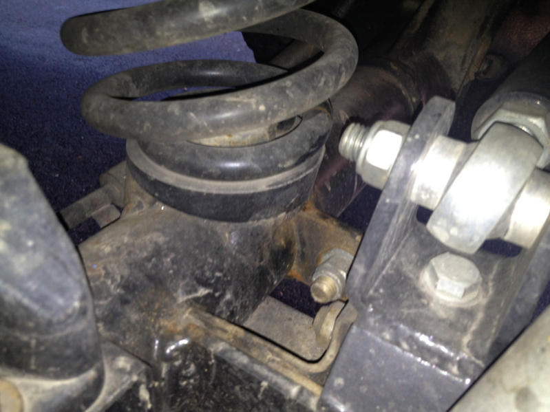

Originally Posted by mpkelley20
Can't tell from your pics but you do have a track bar relocation bracket right? You can see the one I have in my first pic that is bolted and welded on.
I do have one. But not rock krawlers bracket. That's probably the problem.

Can you post a better pic of the bracket at differAnt angles please?

Probably. The RK bracket is on the axle by the shock and pushes it out an inch or so. Gives that little added clearance needed.

Here are a few

The location looks the same as mine. Maybe I'm ok there. Looks like I just need to move my swaybar back one inch and I'm fine.

Check the angle of your links before you move it. Maybe it's ok. Mine was definitely off so I followed RK instructions and moved it.

I'd double check the length of the lca's. they look to short. How is the pinion angle? Also rotate the springs so the pigtail ends at the rear of the jeep. I had these same issues

My driver side shock rubs a little... Ome shocks.... But it isn't bad. My rear sway links bent on the first offroad trip, but when I was moving it back a bolt broke so I just removed it. My track bar was also rubbing and in a bind, so a friend welded a bracket on the passenger, moving it back a little over an inch. No more problems.
