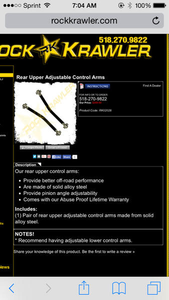

As far as I know there is only one length upper arms (bout 99% sure). If you use their uppers you have to use there longer lowers or you won't be able to adjust the arms enough to get your angle right in the rear. Or you can do what gun dude did and cut them down and then use with their shorter lowers or stock arms. This was all confirmed by RK when I ordered mine.
Old Oct 29, 2014 | 04:05 AM
Baddkarmaracing's Avatar
Joined: Jun 2014
Posts: 577
From: Harlingen Texas
Yep they only have one size uppers listed on the site. If they had 2 it would show ordering options for both.

When I called Northridge to order they offered me the short upper and and the long uppers.
