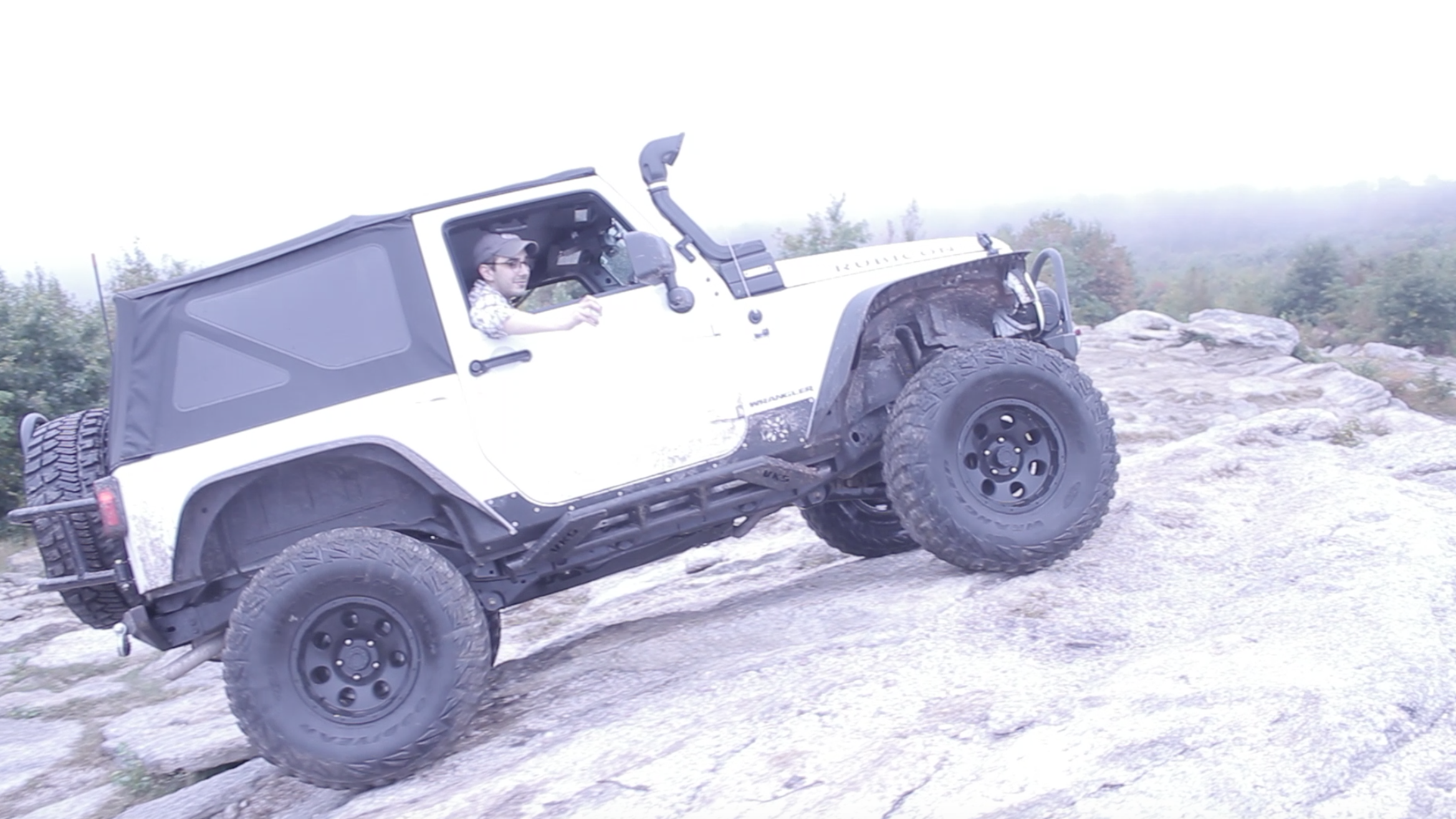

I'm in love with my Ace sliders. I've dropped the whole weight of my jeep on them several times and all I have to do afterwards is rattle can the gouges. They are frame mounted and they also side as a nice step. If you are going just for looks, you can get by with body mounted sliders. Depends on if you want them to function as a true slider, or whether they are primarily for looks/ease of access.

These. Not sure if they make others for the JK. One side note, they do have to be paired with rubicon sliders in order to cover up the fugly pinch seams. Used rubicon sliders go for cheap on CL.

If you plan to wheel hard in rocks and don't want to worry about damage, you will want a set of frame mount sliders. While the ACE are nice, they mount to the body mounts and if hit hard enough, flex into the pinch seem and damage the body (lots of documented cases). Similar issue with body mount, but that damage is usually worse. Neither is easy to fix. In some cases on a JKU, it is enough that it bends the b-pillar and you can't even get the door to shut.

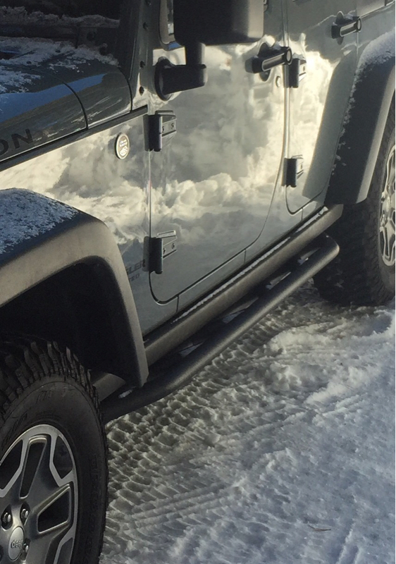

I have the Barricade Rock Sliders and chose them because they would mount easily under the stock Rubi Rails (like the Ace sliders do as well). I have only dragged them over rocks a few times but they have been very good and the finish has held up well.

Mine have held up perfect no matter that they attach to the body mount. I still consider those "frame mounted". However I do agree with the above. If ur gonna beat them to holy hell, go with true frame mounted weld ons.
