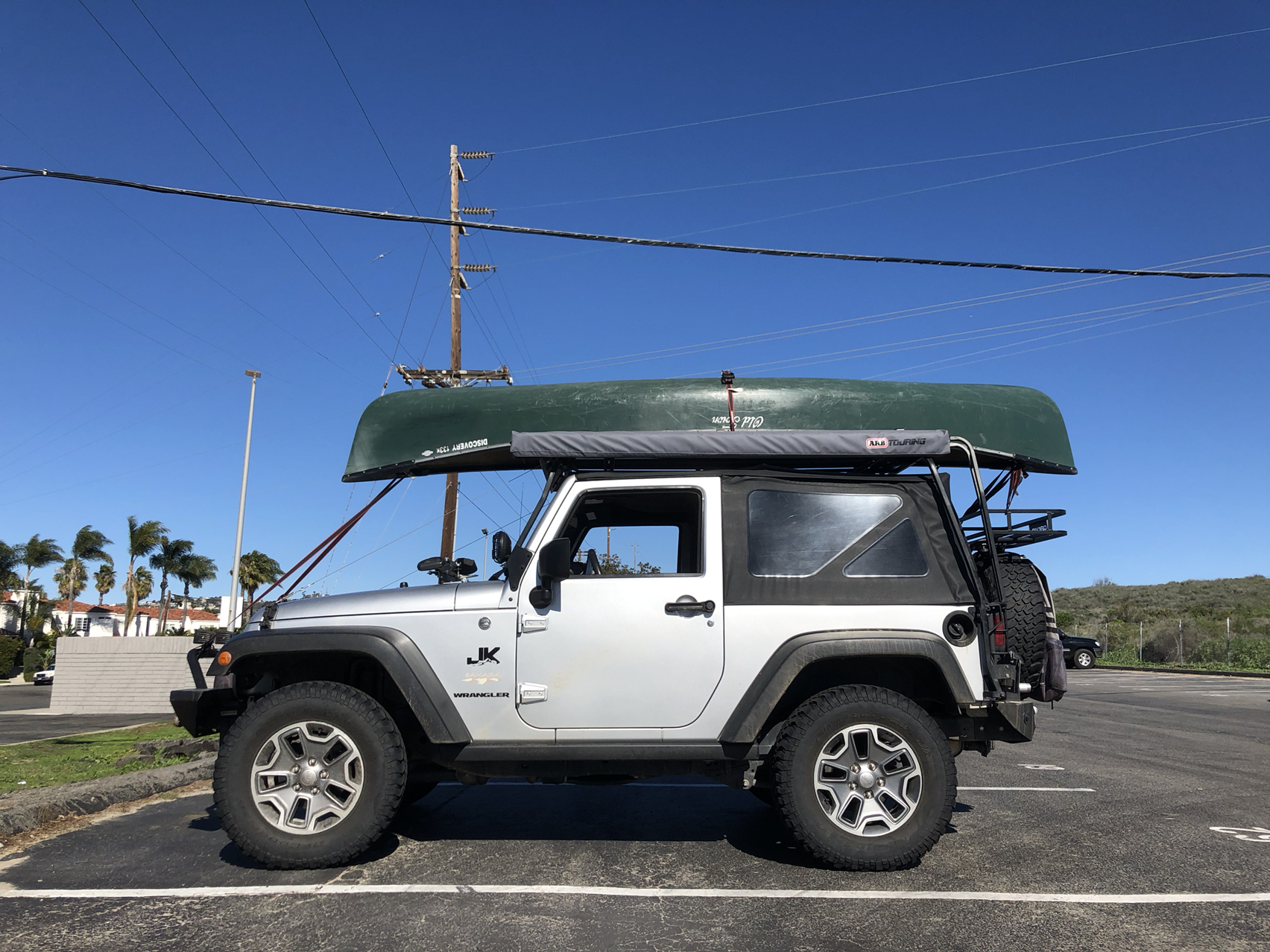

I have the Garvin and love it. USA built and solid as a rock. Been through plenty of abuse off road and just trips to Home Depot. It swings back to remove the top. Good thing is that even without the top you still have the rack. It holds 300 pounds offroad and much more static in camp. I have a review video I'll add a link to and I cover it in great detail and show you how it works for top removal. Customer service from Garvin is also top notch. Hit me up with any questions.
