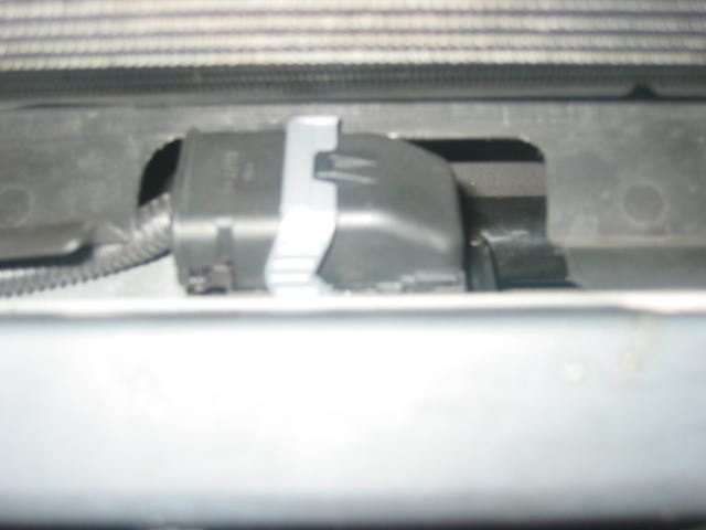

Here are some pics of my bumper and E-Diso, and the room I have to play with...

Yes, it does move forward a bit, but not much. Looks like you'll be pretty tight with that bumper. The only way to verify is by doing it without removing the bumper. Do it from underneath.
My winch is also recessed between the frame even more than yours and it fit with the disco motor rotated, but just barely. The casing on the Warn 9.5xp is pretty compact. I don't know about that superwinch though. Although you´re a tad higher, it might work. You need to fiddle with it a bit.

If it moves it forward very much I might have problems... You're correct, It's not so much the winch that I am worried about, it is the design of the winch mount. You can see in this pic just what my concern is, there is not a whole lot of room there...
