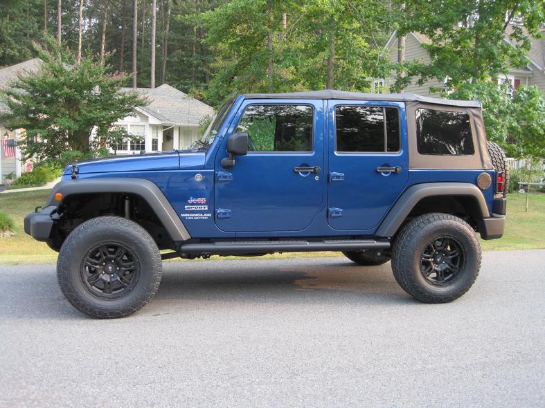

I have RC 3.25 lift with 2.2 series shocks...See Pic
