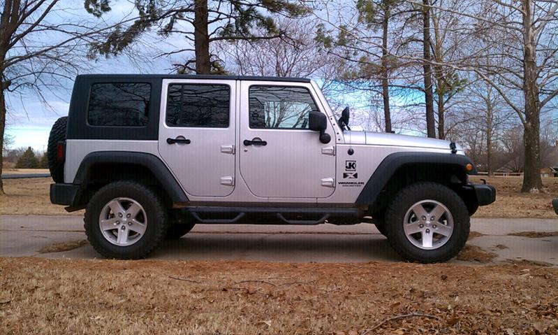

I have 275s or 32" Goodyear wrangler tires, they are about 3/4" wider than stock, also I have 1.5" offsets with stock rims; do you guys think it'll look stupid if I add the 2.5" boost?
Old Jan 18, 2011 | 07:55 AM
jrhouse24's Avatar
Posts: 41
From: memphis, tn
Default yes
this is what it'll look like
but keep in mind that this one has an aev bumper and that will make it look more aggressive. with a stock bumper it'll look even more strange

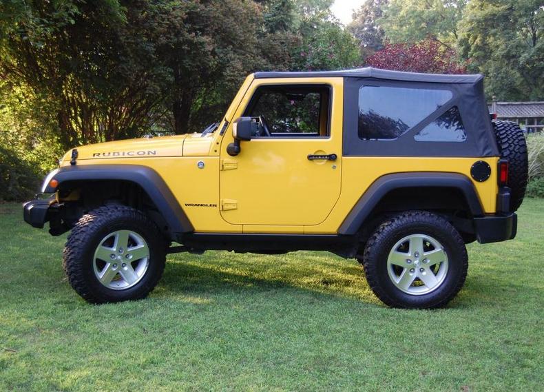

Jimmy - I did the RC 2.5 inch BB and have had 0 issues. I am also running the stock tires right now as well until I can afford 35's. It rides and drives great even doing wheeling.

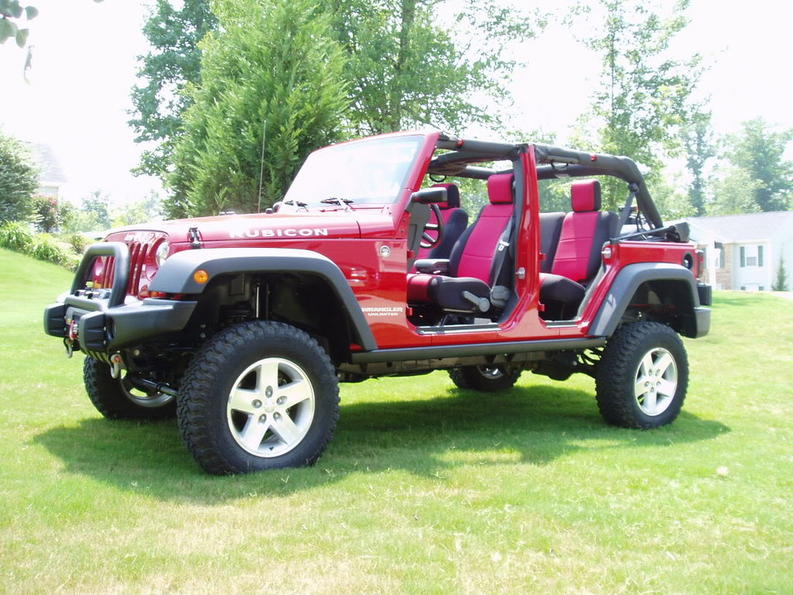

Im running the RC 2.5 BB on my 09 X model with Rubicon springs and shocks. My cousin and I installed the lift ourselves in about 4 hours. I got the lift (series II, $179.99) with the rear sway bar relocation bracket as well as the relocation brakeline brackets and shock ext. I'm very pleased with the lift and look it gave my JK. I have had zero problems with it!
ID:	119183   Click image for larger version
