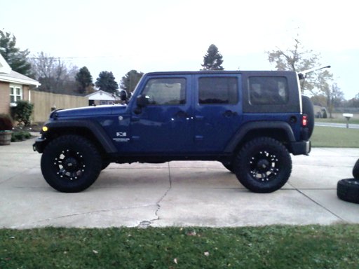

I didn't think it looked to bad. Defenitly needed larger tires but its not a hideous look.
Nice looking rig!
