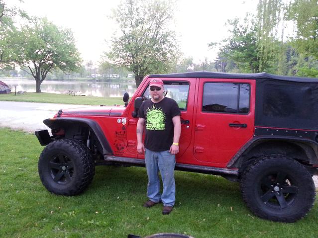

I have the 3.5 inch lift my Jeep is a 2010 with 65000 on it it rides about the same as stock and off road it has no issue's I used an adjustable front track bar instead of changimg the pitman arm. I have a steel front and rear bumper and armor corners woth no ossues yet tje lift has 40k miles on it

Nice. Thanks for the input. I find VERY few complaints from people that are actually running the kit and those that did have issues were well taken care of by rc customer service. I've found that most complaints I see are based off past issues with rc kits or the "my buddy said..or rc sucks (generalized) etc". I'm taking that into consideration as well
Again.. not discounting anyone's opinion or help. Thanks all
