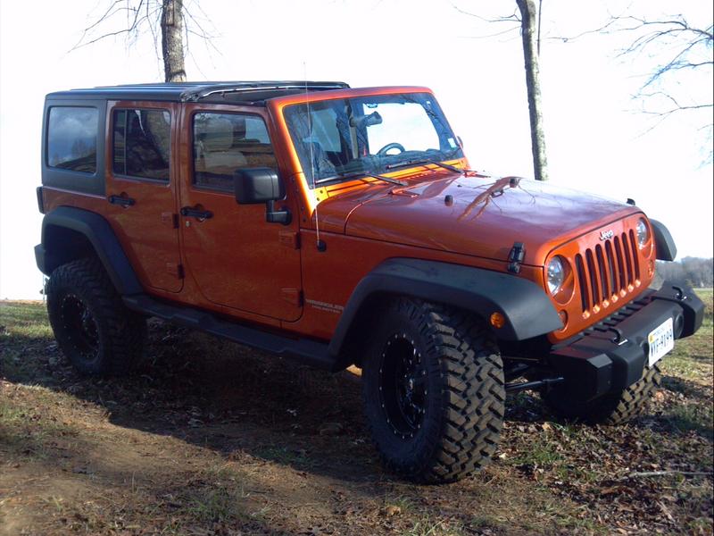

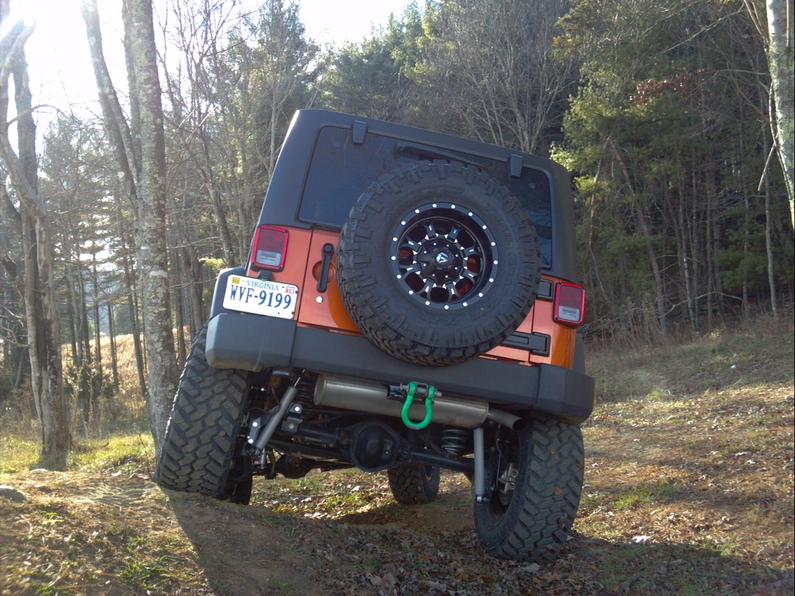

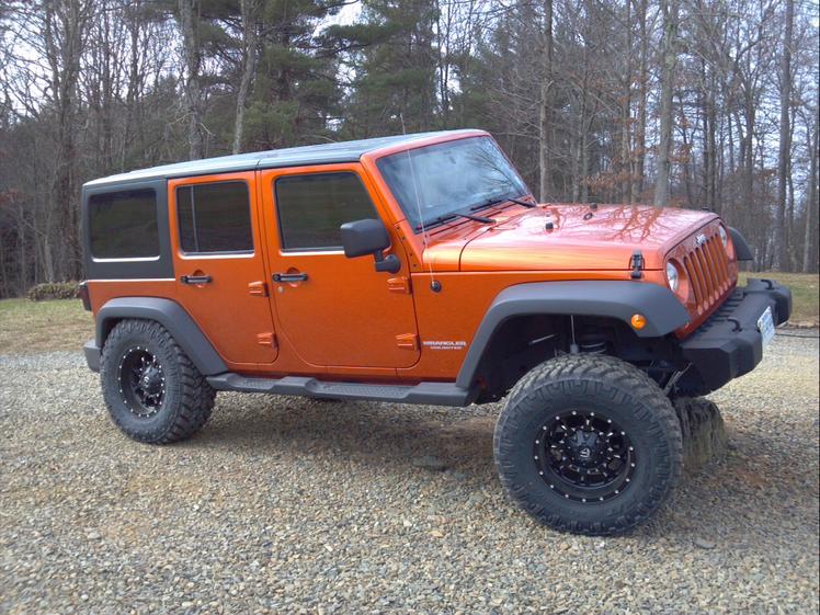

I just wanted to write a review on the 3.5RC w/8-adj arms, 2.0 shocks, disconnects, and adj track bar.
When considering this lift I wanted the flex of the adj arms but the height of the 3.5 lift. I call RC and asked if I could change around their kit to accommodate my wants into a lift. They were great with piecing this kit together for my needs. Everything went together with no problems and the instructions where great. I had to adj the arms a bit from the instructions to create the correct drive angles due to the shorter coils and had some issues with the 2.0 shocks missing the shock mount posts but that was resolved with one phone call. The 35's will definitely rub due to no bump stops because of the 2.0 VS the 2.2 shocks with the integrated bump stops on the shocks. The drive and ride is great considering the height and tire size. It's not as soft as the factory but very tolerable (the kids complain when using there I-pads on a bumpy road lol). I will continue to update how over time this kit is holding up. As for Rough Country they again far exceeded my expectations for the quality and price of this lift. Thanks again on a quality product and over the top customer service!!!
