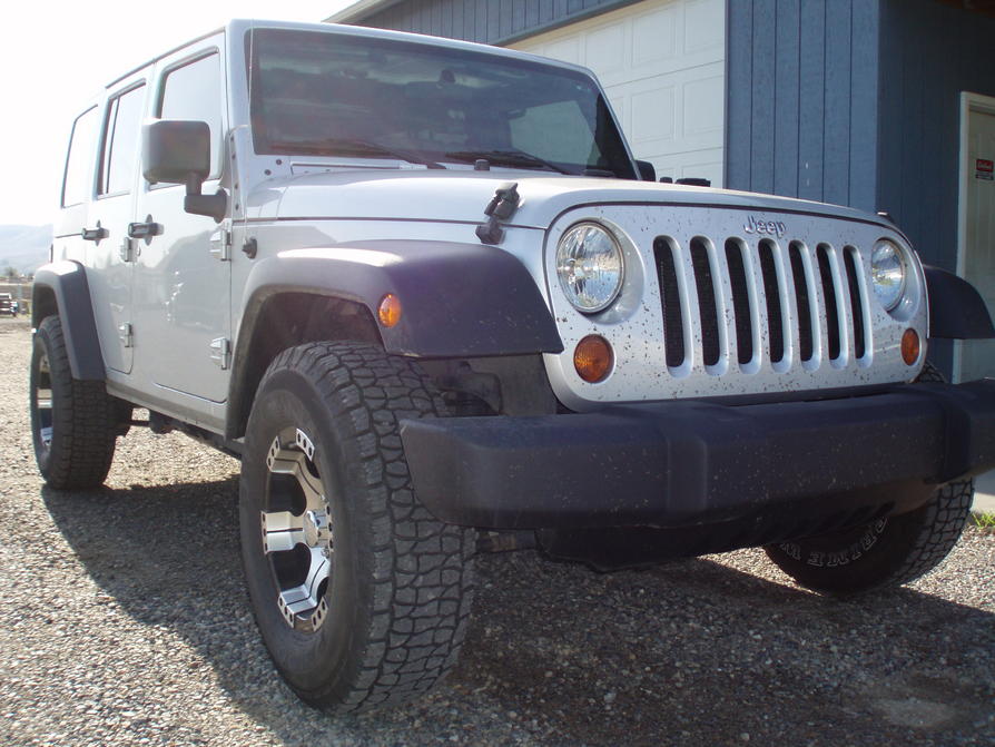

Some pics of the RC 4 inch with 32.5's by 10.5's, roughly. Some before and after pics. I think you're right I'm gonna need bigger tires.

Give reviews. I'm looking at this lift for my 2dr. Is the ride good?, was the install easy? Did you get anything else to go with your Jeep? like adj track bars? or control arms from another manufacture?
